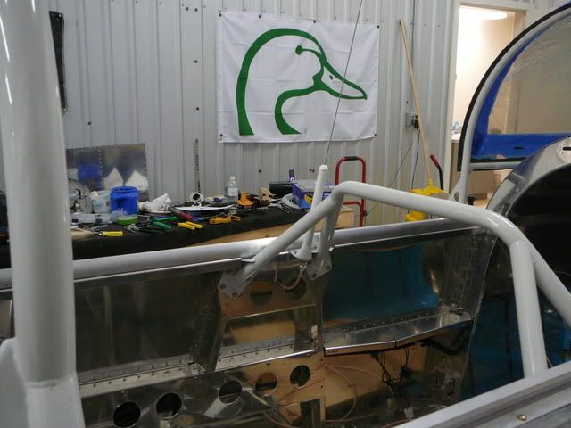

Default ELT Antenna
Here is mine...I fabricated a small bracket with and angle similar to the mid cabin cross bar. When the canopy is closed it does not touch the bubble. I position so that none of the antenna assembly touches the mid cabin brace as well....
