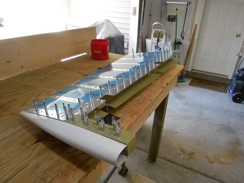

Default Pre-Thanksgiving Progress
It has been slow going with all of my travel this summer but with the exception of a couple of short overnight trips to DC, I am home and can work on the TARDIS (an ode to my kids favorite TV show "Dr Who").
The wing build-up continues with the wing tips drilled and fitted to the wings. I am using the Cleveland RV wing tip kit with #4 screws and nut plates. I do wish the -8 wing design had an additional inspection plate toward the wing tip. I am contemplating adding one. If anyone has done this type of mod I would be interested in getting some pictures.
I found a Sherwin Williams product called MacroPoxy. It has a heavy solid content and gives more of a textured feel which is what I wanted for the floors and seat pans. It can be tinted but I like the gray of the base color.
For the control sticks and side panel accents, I am using a metallic cobalt blue. This will be the same color used for the exterior waves/accents.

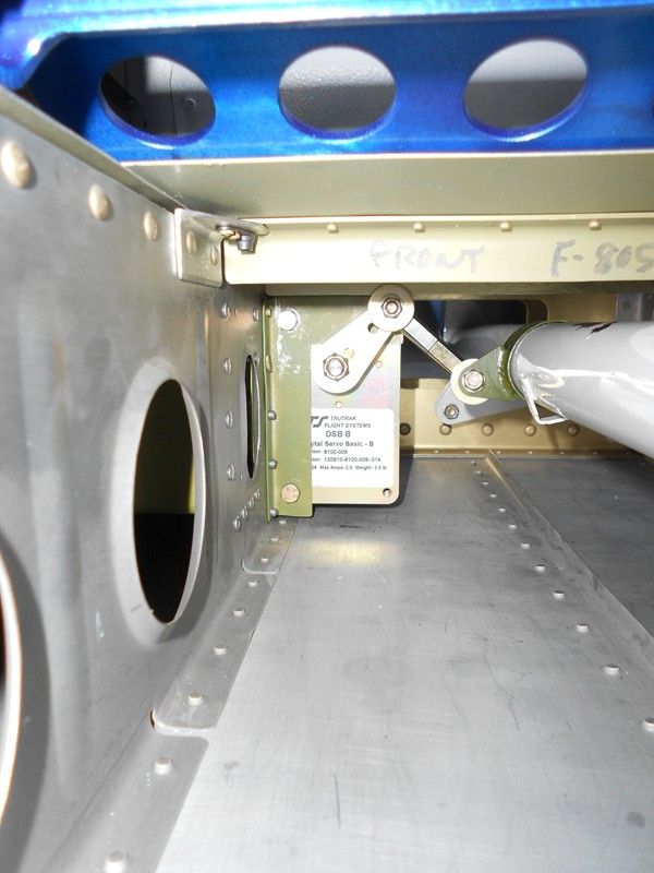

I did manage to install the roll and pitch servos for the TruTrak GX Pilot but discovered I put the roll servo too far forward so it hits the front seat floor stiffener. A little trimming and adding a second stiffener is the plan.
One thing I have discovered is extra care is required when working in tight spaces like a garage with both wings and fuselage (with horizontal stab mounted). When I was flying F-15Es we called them "Eagle Bites" - injuries sustained when working in and around the aircraft. It is her way of showing love in return!

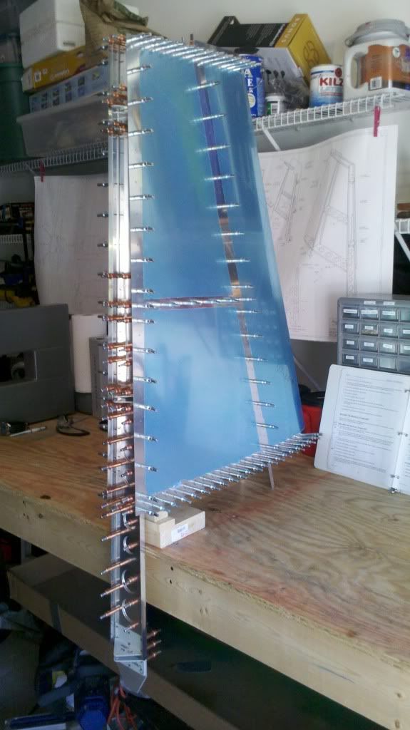

Back to work in the new shop. I did an acid wash and alumi prep conversion coating followed by an Azko prime layer of the internal rudder and elevator parts (the parts below are pre-primer).
To rivet the stiffeners I routed a cut-out in my bench and put in a small back riveting plate.
After a little rivet tape to hold the 3-3.5s in place, flipped the rudder over and got to work.
There was some additional riveting of the rudder skin but had to quit when I put a Phillips screwdriver through my finger (don't ask ... the only advise I can give is NEVER use a screw driver to help displace a blind rivet stem from the tool). I am giving new meaning to sharing your blood to provide soul for the airplane!

After a couple weeks of travel, I finally primed the elevator parts and got to work.
After reading about how to use 2x8s or 2x10s to create a bending break for the rudder and elevators, I decided to incorporate it into my work bench. When not in use it is the back splash and when I need, it is a very stable, convenient tool.
Since my squeezer yoke is not deep enough to get around the rib flanges, I had to get creative with the back riveting plate and tungsten bar..
And after about 5 hours and a little help, I am ready to close up the right elevator then move on to the challenge of the left side.

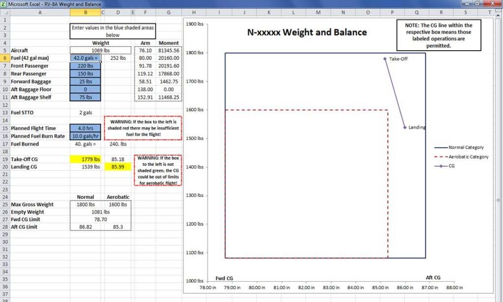

As I wait for replacement parts to be shipped and time to prime, I put together a Weight and Balance spreadsheet to run different scenarios. Obviously the end result numbers will be different but I can play around with the CG to see what my final operating capacity will be. If anyone wants a copy of the file drop me a note.

Mike: That really looks useful, with great features. I would love a copy if you don't mind, at least if it will run on Excel for Mac.
