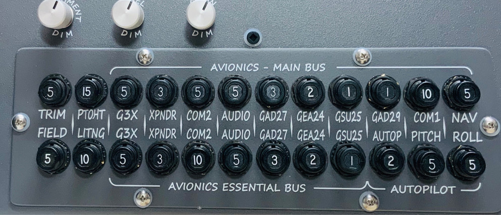

Otis: great-looking panel - glad I saw it as I'm ordering up my G3X components.
What is protected by fuses, and why?
thx
thx
Thanks, great question. It was my hope that this post would be of some use to builders in the process of designing their panels. All of my primary component electrical protection is via pullable breakers but there are also two lightweight fuse blocks. One is not accessible in flight and protects non-essential things like the USB charger, certain lighting components, etc., and the other, visible on the center console and super-accessible in flight as it protects essential loads, the twin plasma III ignitions and the twin electric fuel pumps(there is no engine driven pump on this bird). Note that each of these loads has arbitrary, full-time access to either of my two EarthX ETX900V batteries, so each requires not one but two fuses for individual protection. I elected to let both fuel pumps share a single fuse to each battery, though. Much more on the battery system in a future thread- truly exciting stuff.
The best answer to your question(What is protected by fuses and why?) is probably “Whenever it makes the most sense”. Breakers are a lot heavier, and their wiring takes up far more space, so using them on low-load, peripheral accessories becomes harder to justify. - Otis
Here are the things I deemed worthy of breakers:
Note that most Garmin components have two power inputs dioded from one another so each requires two breakers if you use them both. I took advantage of this by feeding power from the main avionics switch to the p1 inputs on everything in the long bracket on the top row. P2 inputs bracketed in the bottom row receive power through the Aux Garmin Power switch at the top of my center console, and that double throw on-off-on switch has direct full-time access either EarthX battery. A huge advantage of this is that I can power partial avionics off the auxiliary bus switched to one battery, choose the other battery with the master switch for starting the engine before energizing the alternator field or main avionics switch. Thus the electronics see nothing of the voltage caos during startup. As I recall the GTX345 power inputs may not be dioded, but this is easily remetied by adding diodes to the respective power feeds.
Great answer!
My plane came with circuit breakers, and when I'm doing large database uploads, I pull the breakers on everything that's not getting data uploaded... or new software. Don't know how much this preserves the battery, but might make a difference when it's getting low.
I've got a switch installed, but not yet wired, that will give power to the two display screens through their built in, diode protected secondary power input, so I will be able to turn them on outside of the master switch when doing database uploads. This power source uses a pre-existing fuse on the battery charger.
