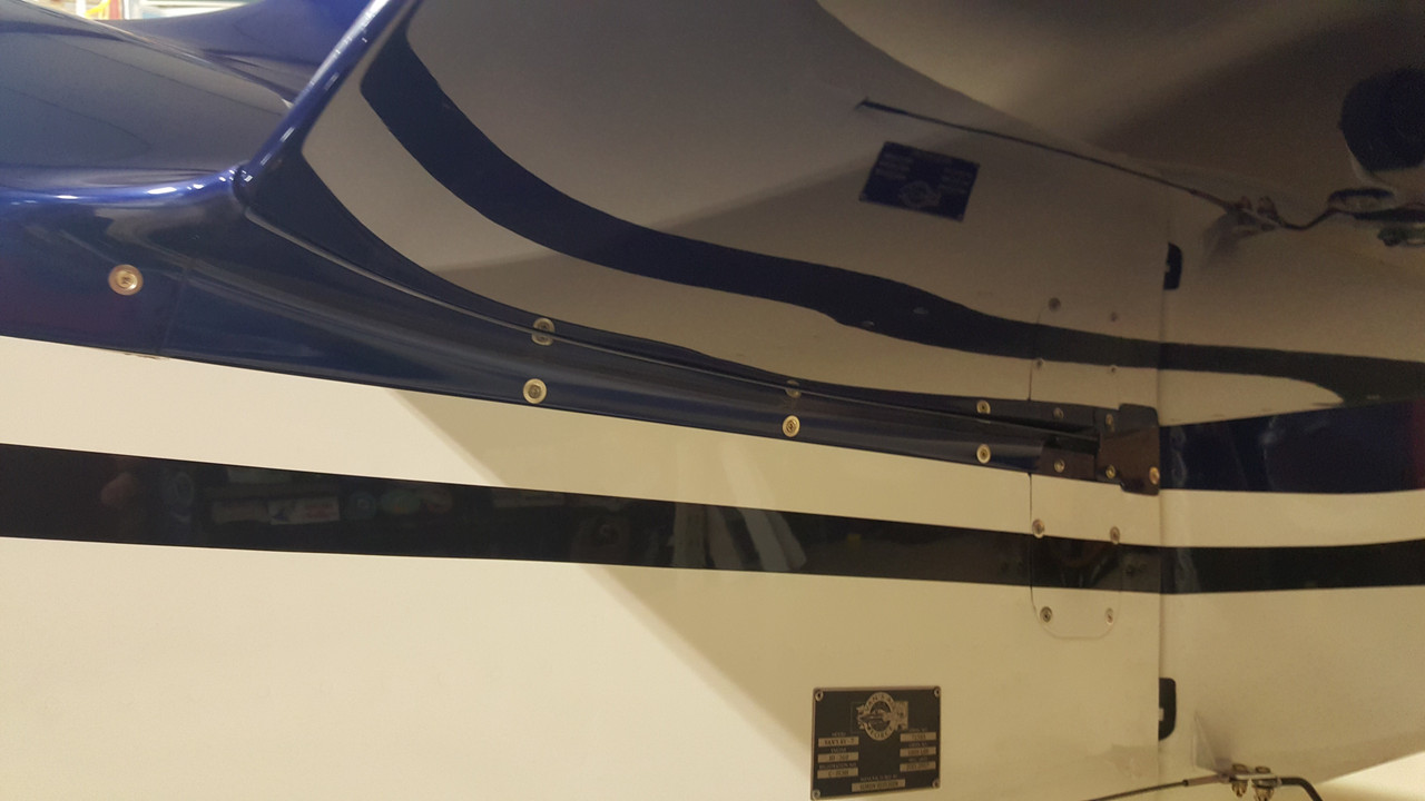

Fellow Fairings-Etc tail fairing customers, would you share pictures of your fairing installation, especially the lower fairings? I'm particularly interested in how you attached the lower fairing to the fuse and whether you installed any fasteners to the underside of the HS.
I've done several forum searches and most of the links I've found have expired picture URLs. Any new info would be much appreciated!

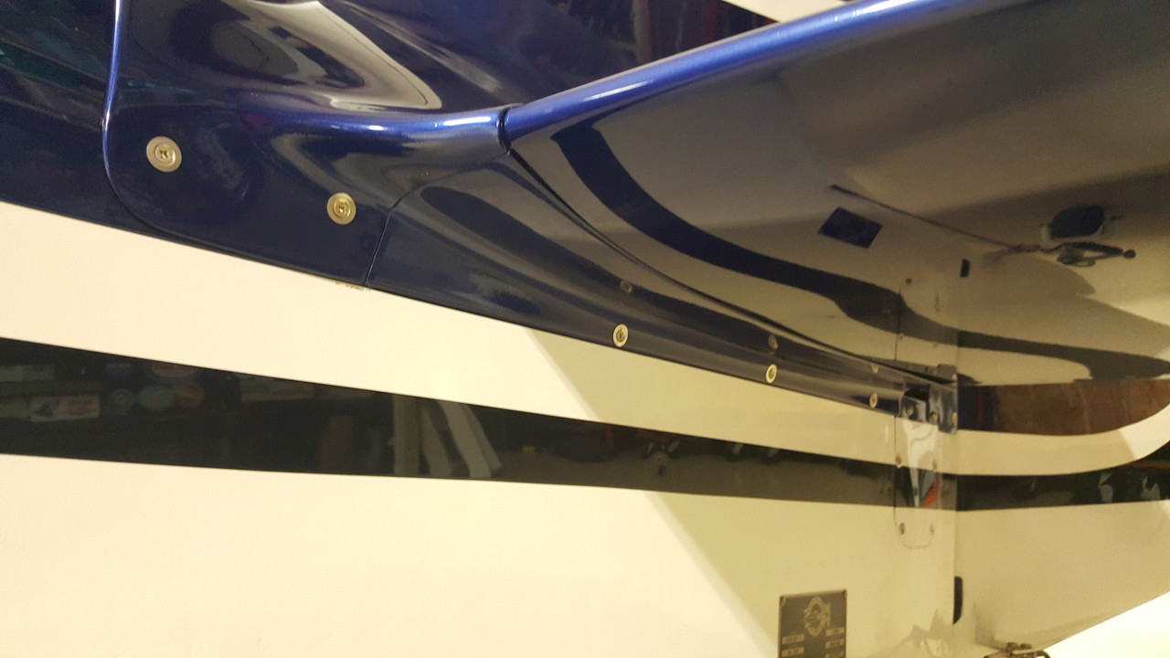

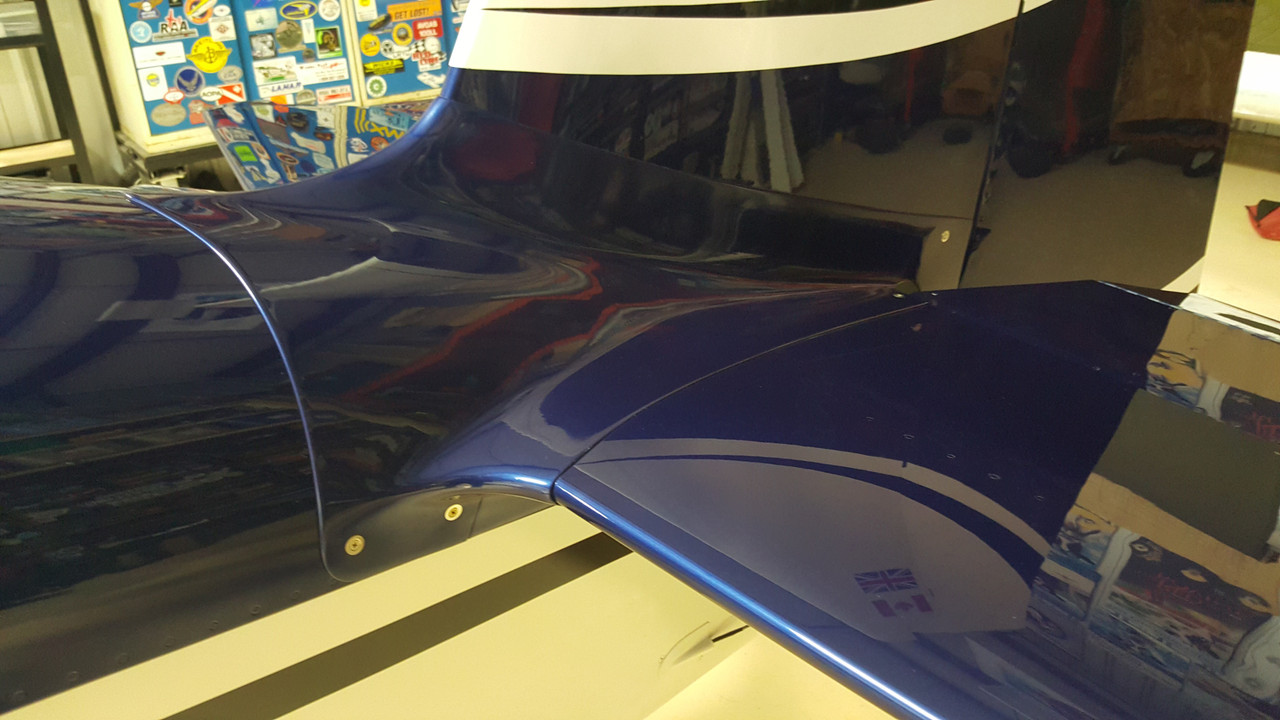

Three shots for you
Hi Dave, a friend of mine was at this exact stage and asked for a few photos of mine. I still have them so I’ll forward on to you. The fairing does take a lot of work to get right but it’s worth it. I used a lot of packing tape and mold release on the fuse and screwed many parts down with flox between them to get a good fit.
I went straight into the top longeron And tapped for 6-32 screws. I didn?t attach it to the HS. The only attachment to the HS is the most rearward screw on the top fairing because it just wouldn?t sit totally flat.

Mine took a small amount of fitting, but out of the box this was miles ahead of the one I got from Vans
The lower fairing has a lip built into the front so it that fits under the top fairing.
Hi Simon, quick question - are those two forward screws on the side of the upper fairing going through the longeron or to nutplates?
