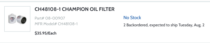

Champion Oil filter - CH48101-1
dbaflyer
Looks like I won't be ordering any at Aircraft Spruce anytime soon. 3 month back order?
Yea, I saw that too! I was able to snag a 6-pack of the Tempest equivalents; the individually packaged ones seem low on stock as well, generally.
Would the shorter CH48108-1 work just as well as the 48110-1? Available in a couple weeks? I wouldn't just assume it is but it mentions that it is shorter than the 48110 in its description.
Aviall/Boeing has the 48110-1 in July.....
