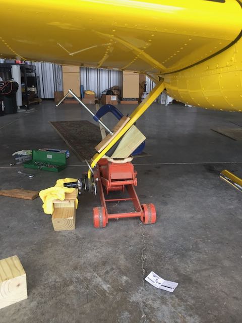

To life my RV-12 to change a tire or brake, I use a floor jack. I have two pieces of 4 X 4 that I have cut at an angle to match the floor. I have rubber padding on one side of each piece. I then use a large C clamp to clamp both pieces securely to one landing gear. I then jack it up with the floor jack. It works well to jack up one side at a time. here is a picture.

Interesting thought, Jim. The geometry of the lever arms when jacking up one side is a little different since the pivot point is the opposite tire. If I was worried I?d probably go through the gymnastics of calculating moment and compare it to 1G flight, but given that I can crouch under the wing and raise the tire off the ground using my back I don?t think the force involved is worth the math. I am much more feeble than the spar,😜
