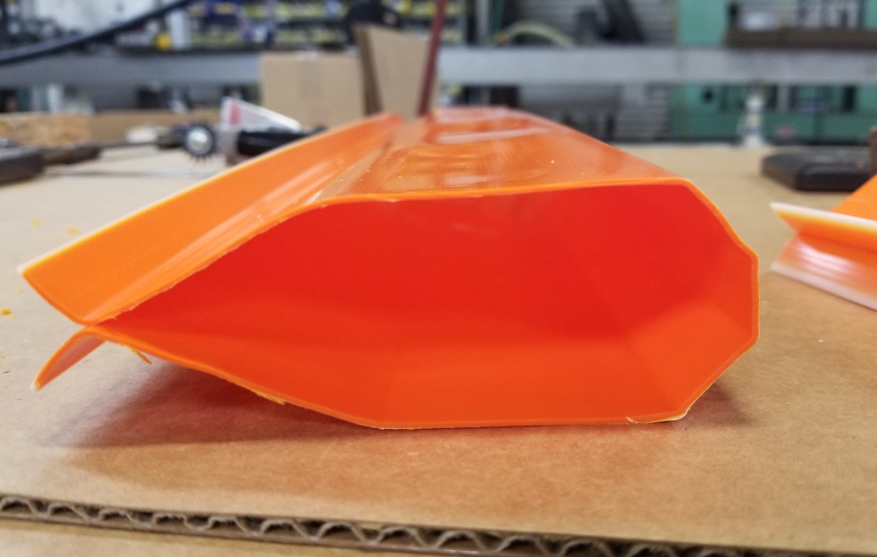

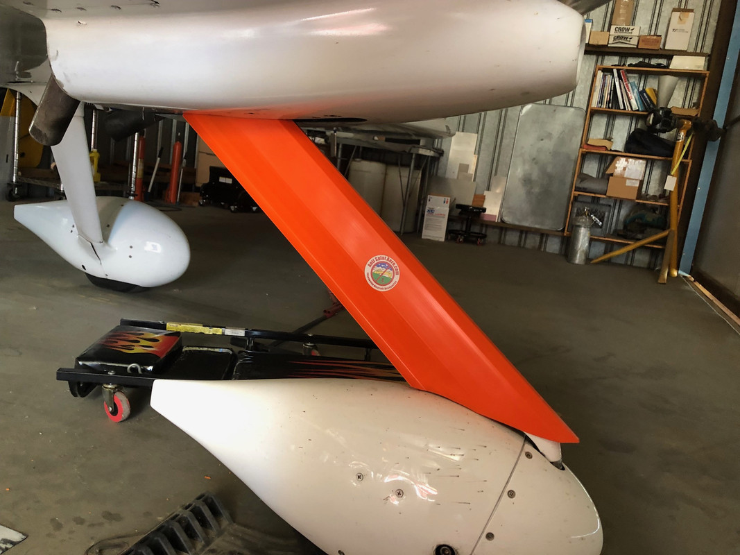

?.Many people are not aware of one of our new products now available on our
website that vastly improves your odds of not doing paint and glass damage
when removing your lower cowl or working on your plane. You just pop this on
and you will have some serious protection in place. Please have a look and let
us know your thoughts. Thanks, Allan...

...These really do work great, and they will last the life of your airplane! We
have them for all RV models as well as many other aircraft. Thanks, Allan..
