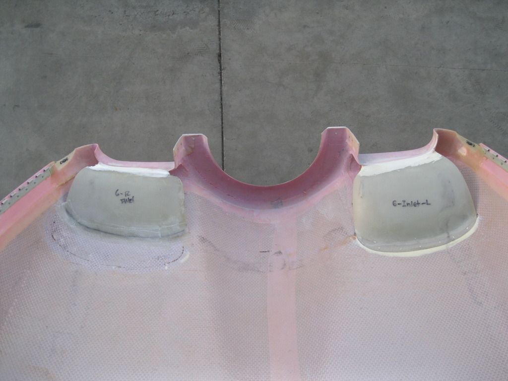

I saw an RV that did NOT have the fibreglass cowl inlet ramps installed on the underside of the upper cowl. So wondering what their purpose is and if others have left them out? I am at the point to install them but do i really need to ? Maybe i wait til after flying and only consider installing them if i have heat issues - CHTs ? If this has been discussed please refer me to the right search term.
Thanx
Thanx
The short simple answer is they are very important... the reason the are supplied in the kit.
Yes, they are necessary!
And for a slightly longer answer. These ramps smooth the airflow coming into the cowling. Without them, especially in a climb configuration, the incoming air becomes turbulent and will not cool the engine properly.

That is not needed and is actually redundant if the Van's supplied baffle system and associated seals are installed as intended.
Yes but I think there is a minority that achieves the "as intended" especially around the nose section. For them, sealing will provide a cooling improvement.
That might have been the case years ago, but i don't think it is any more.
Regardless, plugging the inlet ramp to prevent plenum air flow through them is applying a bandaid to the problem. It may help, but there will still likely be baffle and seal issues that will cause poorer cooling performance than if it was done right.
Sorry Scott but I dont accept that the new baffle kits will work as desired without adding custom fiberglass work to the ramps in order to provide a surface for the seal strips to ride on. On the -M1B application there will be a couple of inch gap on each side of the nose where the seal comes off the inlet ramp and jumps to the cowl surface. I have seen plenty of installations that have not dealt with this problem. That gap needs to be fixed or the ramps need to be sealed (As a less effective bandaid)
I dunno about new baffle kits, but I have observed that the average builder does a sorry job of sealing both the inboard and outboard sides of each inlet.
Extending the ends of each glued-in upper ramp may provide a better surface for seal fabrication. Simply closing the ends of the ramps is probably a waste of time.

What kind of clearance between the #1 cylinder and the inlet ramp (at the "pinch" point, measuring from the cylinder head or barrel) is good to have? What do some of you have on yours? My #1 and #3 both run a little hotter and I don't have that much space there.
Hey Mike,
A lot of folks suggest that you should be able to get your fist between the leading cylinder and inlet ramp. In stock form, the left side ramp was just about perfect, but I cut and re-glassed the right side (left in picture), moving it forward to approximately match the cylinder stagger.
Temps are quite even now in cruise, though #1 is a little hot still in climb. I've cut the air dam in front of it a little more, and will see if that helps on my next flight.
As a data point, the ramp to #1 cylinder space on mine is about a fist. The ramp to #2 cylinder space is several inches larger. #1 and 3 cht's are evenly cooler than #2 and 4 cht temps.which are evenly hotter by about 20 degrees. In retrospect, I probably should have installed the ramps to better reflect the stagger of the cylinders.

If an installation requires a cutout in the upper ramp, it can be sealed with flexible foam, or a solid recess can be built in to mirror the governor. Either way, there is no reason for a leak.
Hi Larry,
The existing baffle seal worked just fine with the relocated ramp. I was prepared to cut some new seal pieces, but when I stuck my hand inside the inlet and pushed against the seals, they made nice contact on the ramp. Of course, it might vary depending on how your seals are cut.
Here's what mine look like. I went with a pretty decent overlap.

No, that statement doesn't apply to an installation that has a fwd gov. (there were generalized comments implying it should be done in all circumstances... the reason for my comment). When a fwd gov. is involved, just closing off both ends of the inlet ramp does not seal the leakage path.
I think the RV-10 inlet ramp seals the outboard end so only the inboard end needs to be dealt with.
I cut a piece of soft foam to shape that can be glued inside the ramp, with an ~ half circle piece removed so that it conforms to the top side of the gov. body. It gets positioned laterally so that it aligns with where the upper baffle seal meets the inlet ramp
