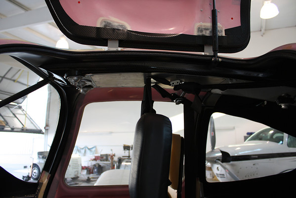

Here's what I did for strap hangers
http://www.mykitlog.com/users/display_log.php?user=MauleDriver&project=224&category=7984&log=152315&row=4
For headset holders, I took a length of soft aluminum tubing (fuel tubing), bent it into a J hook, flattened a small section to drill and put a screw/rivet thru and fastened to the bulkhead that's down by your ankle. The location keeps them out of sight, out of the sun, and easily at hand.

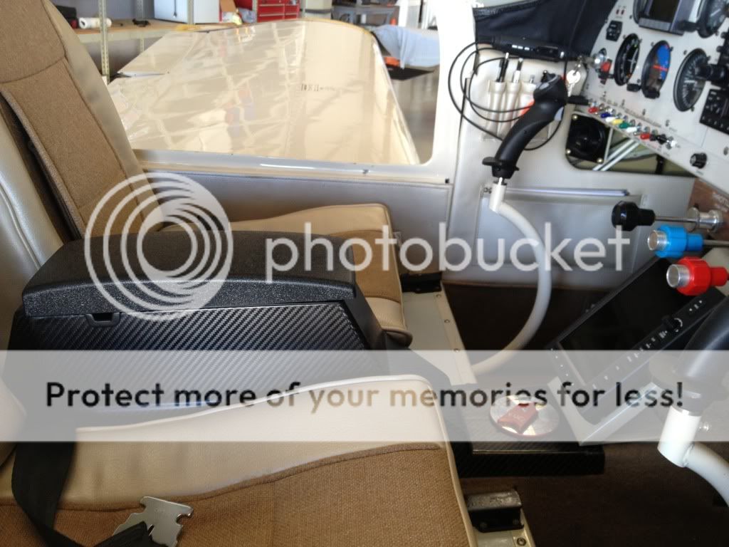

I got a self taught crash course on the dismantle of the interior yesterday. The pilots stick grip had a bad hat switch, I called Tosten, explained the problem and he sent me a new one free of charge. Didn't take long to figure out I was going to need to remove the seats to get to the wiring. Without the search features here, I couldn't imagine how long it would have been fumbling through how to get the seats out. It also gave me a chance to pull the tunnel cap off and get a good look of the infrastructure.
I added a 696 and a console, not sure if I want to paint the console or cover it, its going to get a lot of abuse and I'm not sure how the paint will hold up.
