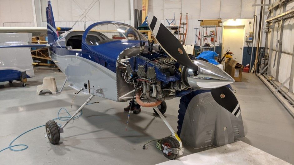

Old 11-20-2020, 12:26 PM
dreed dreed is offline
Join Date: Nov 2016
Location: Camas, WA
Posts: 478
Thanks! Worth upgrading the tubes initially at least? Out of paint and reassembling now so not a horrible time for me to do it before wings are back on, pants etc. So many horror stories about stock tubes.

Old 11-20-2020, 12:43 PM
Steve Melton's Avatar
Steve Melton Steve Melton is online now
Join Date: Apr 2011
Location: Cincinnati, OH
Posts: 3,121
perhaps the tubes, then you will not have to air so often. dream machine. it's a bullet!
