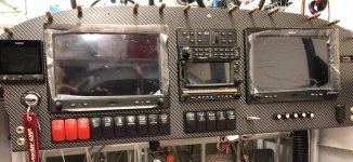

About what I did with my panel. I went with the bigger switches, so I had to go to the panel that is 2” lower to fit them in.

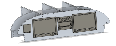

Vans and Garmin both publish 3D models which can be used to fully mock up the panel and work out these types of interference issues. I started the really rough mockup in the attached images using Fusion 360.
Andy,
By the way, thanks for the mock up it really helps me figure out the center stack hole location.
