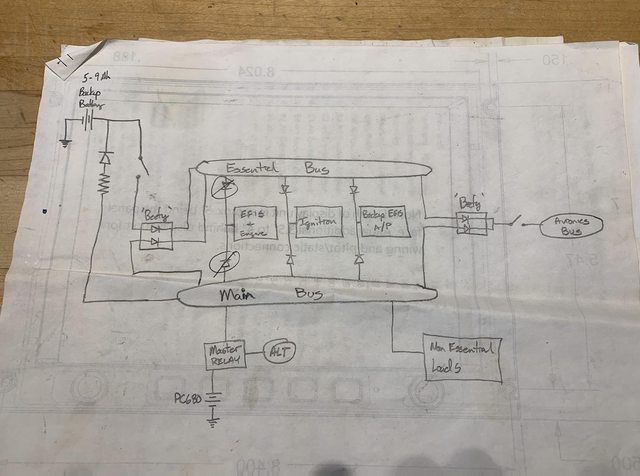

I know the pros and cons of an avionics bus/switch so not looking for advice about that. And, I've done a search and can't seem to find an answer.
I'd like to put my com radio on an Endurance bus but still have an avionics switch controlling it and the remainder of the avionics not on a the E-bus. I can't wrap my head around a possible way to do this. Thoughts? Maybe I just put it on the E-bus with EFIS #1 have it on during engine start

I used to have the eBus fed through a diode from the main bus and alternatively through a switch powered from the battery bus. (Aeroelectrics diagrams).
In a couple of weeks, I will redo the electrical system on GERZ. I plan on the aux battery to feed the radio, EFIS ans engine instruments directly. Both main bus and aux bat would feed those through Schottky diodes. The Aix battery will be a LiFePo4 maintained by a Dc-DC adjustable voltage and current converter.

Schottky diodes are your friend. I used them to provide many power paths to my essential items without me having to do a thing. The Avionics Switch is to isolate things during a start. If I get down to my E-buss, the avionics switch will still stay on, I will use individual power switches to shed loads if needed. As it turns out, the E-batt can power everything for 30 minutes plus (limited comm transmissions), which ought to be enough to get my plane on deck in IFR conditions. I confirm that performance every year before my condition inspection, and then replace the E-batt with a new one as part of my inspection.
