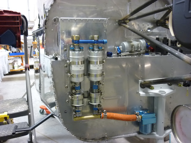

I really wouldn't be putting my fuel pumps there..i.e on the hot side of the firewall sucking uphill.
This is is significantly increasing the chances of vapour lock, especially running mogas. Might be OK but why risk it?
Best to put them in the "hydralically correct location"..I.e at the low point of the system in as cold of a place as possible.
Short dissertation.. Fuel is a high vapour pressure liquid. When the suction pressure (suck of the fuel pump) exceeds the vapour pressure the fuel will boil. The pump cannot pump vapour, or at least not very well. Most suck is at max flow, i,e full throttle. Hot fuel has a higher vapou pressure than cold fuel.
In other words when you drop the hammer on a really hot day with your recently flown heat soaked engine, you might find the engine quits on take off.
Frank
THe items you mention are certainly of concern. In this configeration we are several inches away from the engine.
We plan on adding blast tubes to these items and the voltage regulatior.
We chose to minimize the expsoure to high pressue in the crew area.
Regards
AL

We have done an initial mounting of the engine on a first generation mount.
We will be weighing the RV this week to to verify the installation.
It appears that we may be able to move the engine 6" to 8" closer to the firewall, if so we may be able to adapt the Rotax Supplied Cowl.
We had ordered the materials lasr week.
I just received the materials to construct a modified Mount that
is 5 1/4" shorter than the initially designed mount.
We will report the results when available.
Regards
Regards
Hi Al a new mount sounds the way to go I was a bit duvious about that Far Forward Engine mounting & COG Questions..! Appreciate all the Working & Investigations you are doing to get this Installation up and running Safely Buddy!
Cheers from Oz.
