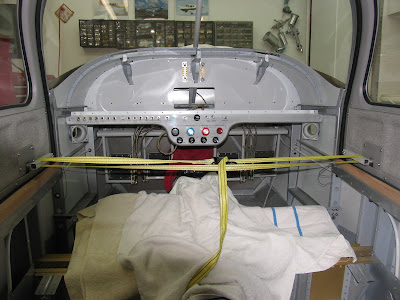

Door Ideas
This is what I installed when I finished the plane two years ago. I have not tested it and I hope I never do, but I think it might save you if you took off with the rear pin not engaged. It is a barbed 3/8 " SS pin mounted to the rack assy. with 3 #10 screws that go all the way through the door. The pin engages a bracket mounted to the door sill. You have to have the hole in the bracket just right so that the door can move as it needs to when latching. When you get it fine tuned the barb catches the edge of the hole and you have to push the door down a little before you can open it. I need to put a placard on the door with that instruction. If you ended up upside down you wouldn't be able to open the doors anyway. That's why I made the baggage door so it could be opened from the inside. The lights are super bright flashing LED"s.
