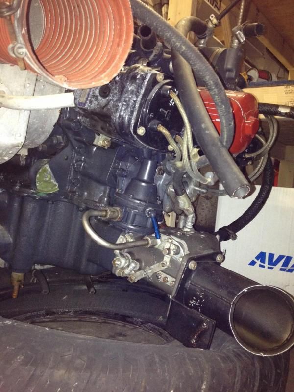

I've been refactoring my fuel line routing, initially going from the fuel pump to the servo along the outside of the sump. But then I thought the line might go nicely below the sump. Sure enough, it's shorter and keeps well away from the exhaust.
Next was from the firewall to the engine driven pump. Does Vans have you just install a short section bent 90 degrees? Does it need to be secured to anything along its span?
What do folks think?
1st half of Pump to Servo
2nd half of Pump to Servo
Firewall to pump. Secure to engine mount or just loop in a wide 90 degree arc?
I think it looks good in general, but you may take note of

Looks fine, do not secure pump/firewall line to mount as it needs to move around. Servo line needs firesleeve.
Yep. The firewall -to - pump hose is exactly how I've been running mine for many hours and has no issues. Pump-to- servo is stainless hardline on mine though. With hardline and it's more defined bends, it made more sense to go over the sump and use the pan studs as attachment points.
Russ---its a good mock up. Yep firesleeve for sure, and the farther from heat an other obstacles the better. Firewall to the pump should also have firesleeve, and be free floating.
I do like Michael's stainles hard line, but he is very proficient at bending rigid tubing. In your case, I think it might be ALOT of trial and error. In most of our cases, flex hose is great.

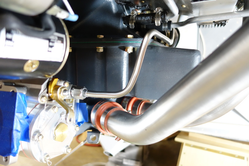

The stainless hardline is very interesting - and well done. I don't believe I've ever seen aluminum hardware on the end of a stainless line before, but the builder obviously knows what he's doing.
Has anyone ever experienced corrosion issues with this combination?
It's not standard practice to use aluminum on stainless (for hardlines - you do see it on hose assemblies sometimes), but that's because of the "mission" of the two materials, not the elemental composition. For the pressures we are running here, aluminum is more than adequate. Once you step up to stainless, you "normally" are doing it in a high pressure (meaning several thousand pounds) application which requires steel nuts. However, in this case, the substitution for stainless tube is only for damage resistance, and yes, fire safety. On the point of fire safety, one could argue the use of aluminum nuts. In my mind, the aluminum fuel pump or aluminum servo/carb will fail when the nuts do, so it's a wash. At the very least, a fire that melts through the relatively thick aluminum nuts will take out the paper thin oil cooler long before, or at the very least, give me plenty of time to turn the fuel off. I've taken a calculated risk to save a few ounces. However, even with the use of steel nuts, you will be well ahead of hose in weight (and cost).
...I do like Michael's stainles hard line, but he is very proficient at bending rigid tubing. In your case, I think it might be ALOT of trial and error. In most of our cases, flex hose is great...
Thanks for the complement Tom. However, the line bending is not that tough, especially if you use that soft line Van provides as a template first. Another trick to getting it right is to use bends on cardinal angles whenever you can. If you will notice, most of my bends on that line are simple 90's or 45's... Makes it very easy to figure out where the line is going to be without any complex math.
Stainless is sometimes a pain, even with a template. I bend .065 wall .375 stainless for my custom fittings, and yes it can still be a hassle, (as one of my very good customers will attest!!! He knows who he is!). For something like what you have, .035 is fine IF you pay attention to the bends and not try to make a real tight radius. Bending .035 really tight will shrink the outside of the bend, and wrinkle the inside.
As for aluminum B nuts and sleeve on stainless, if you had a fire, many other things would burn and cause issues before the B nuts. They look pretty though!

Thanks folks. I think I'll go with the below the sump route. And I'll totally use firesleeve. This is just a prototype run with hose that Tom sent me. :)
For the short 90 degree run between the firewall and pump, my worry is that engine shake will cause the hose to want to twist at the firewall, allowing it to loosen eventually. But this may just be paranoia and the twisting moments are likely way smaller than the torque required to loosen a properly tightened fitting.
I've seen where people have used the facet pump doubler as a pass through for fuel on an injected plane. I added the facet pump doubler before I realized that the plans default to a carburated plane. So I may as well use that doubler instead of installing another.
For the short 90 degree run between the firewall and pump, my worry is that engine shake will cause the hose to want to twist at the firewall, allowing it to loosen eventually. But this may just be paranoia and the twisting moments are likely way smaller than the torque required to loosen a properly tightened fitting...
2 things:
1 - The engine does not have a bunch of rotation when it shakes. If the hose was a #12 or bigger and very short, you might have reason for concern. At the length you are going to use, it will absorb some radial movement.
2- Because you have a 90 degree bend in the hose, any minor radial movement will be dissipated by causing to hose to try coil slightly. Not a problem.

Compared to aluminum, stainless certainly takes more effort - I agree. However, it should be noted that I'm using standard tube benders and flare tools for my lines... The same exact ones every RV builder has in his shop. With those, the bends pull right around the curve just fine (just takes more muscle).
That said, I have made some tighter bends and also some larger diameter tube than I have a bender for. Since I don't have a mandrel bender like you likely do, I improvise by packing the tube full of sugar. This turns the "tube" into a "bar" and you can really tighten the radius up a bunch. Why sugar? Because it will not scratch the inside of the tube and also disolves in hot water.
I'd really like to point out here that these lines I make are not a result of years of practice, specialized tools or exceptional skill... I'm like everyone else out there. Don't be afraid of these hard lines. Spend $20, grab some raw stock, and give them a shot.
No Firesleeve for SS?
So using hard SS lines means no firesleeving is required? I assume that's what you meant when you said "saves ounces and cost." Correct?
Right. The tubing itself is as resistant (more so, actually) to flame as the "firewall".
As for my specific saving of "ounces" - that was concerning the use of alumimum vs. steel nuts. The weight savings for hard line vs. hose is much more significant. Replacing hose with hardline resulted in a net loss of more than 7 pounds (all FWF) on the RV.
As for "cost" - figuring on current catalog pricing for the AN818 nuts ($.91 ea), the AN819 sleeves ($.76 ea) and the tubing at $3.20 per foot, I can make an essentially indestructible 36" fluid line for about $13 bucks. Not sure how that compares with a teflon lined, firesleeved hose assembly, but I'll bet a hardline is considerably cheaper.

You now have an appreciation for how much stiffer this material is than aluminum. This is a clue for their general fabrication. Though the servo and fuel pump are not moving relative to one another, there will be slight dimensional change as the engine heats and cools. So in this case, the general rule concerning bends is, the more, the better. In your case, you have several nice 90 degree bends which allow a little bit of flex without over stressing. Same concept applies to hose- you never want it installed "tight".
Mr. Martin -
There is some precedent for rigid fuel lines in the certified world, though admittedly rare. I believe this has to do with the fact that engines are supplied to the OEM's as "generic" power plants. It would be difficult to fabricate a hard fuel line that took into consideration every exhaust system, engine mount, nose landing gear, etc. Better to supply a hose and let the airframe manufacturer deal with it.
However, you are spot on in your caution that the engine does move around a bit when heating and cooling. That movement needs to be addressed in the design of the tube. It is up to the builder to decide just how to allow for that movement. Hopefully people realize that a perfectly straight, 2 foot long hardline would break very quickly if connected between the servo and fuel pump. But the meandering path taken over and around the engine mount, oil pan rails, etc. as shown above gives a measure of strain relief. The key thing is to just make sure the line does not become a structural member - either in tension or compression.
Bit of trivia- There is at least one retractable gear aircraft that uses a single piece of hardline from the wheel mounted brakes to the fuselage. the 90+ degrees of retraction is accomplished with no flex hose or swivel fitting - it's all done with flexing the hard line. On the SR-71, the brake line travels from the wheel, up the gear leg, then coils around the gear trunion about a dozen times and attaches solidly to a fitting up in the wing. As the gear retracts the hardline bends, but it is only a fraction of a degree per inch through the coil. It's an extreme solution to an extreme mission, but does show that properly designed, even solid hard line can be pretty flexible.
The other difference between Tom's baffles/plenum and these hard lines is that his are made of aluminum and these are made of stainless steel. I also used stainless steel end nuts and steel collars.

I can show with certainty that:
- hard lines work for the governor line on a Lycoming;
- it is acceptable practice to use aluminum nuts and fittings on steel lines (and vice/versa;
- hard lines are used reliably in a variety of applications substantially similar to the fuel delivery on a Lycoming;
- hard lines are used for FWF fuel supply in some certified Lycoming applications;
- I use hardlines FWF wherever possible and have had no failures.
So with all this direct evidence that hardlines work, I still get a bunch of pushback ONLY because Cessna doesn't have a million flight hours on them. Well you know what? Cessna doesn't use plastic brake lines and rod end fittings for flight control hinges either.
So I thought this was an information forum, a place where we could share our collective experience and learn things. Apparently it's nothing more than a customer service counter for Vans Aircraft.
But you are right about one thing. It's possible (likely) that someone will try fabricate a set of lines, do it poorly, and that will be "proof" that they don't work. Never mind all the complete hack jobs that are flying around right now - supposedly "built to plans". I've seen battery cables zip tied to fuel lines, braided hose kinked, chafing and zip tied to the engine mount, Flight control cable rubbing on structure, hinges loose, and a myriad of other obvious maintenance sins. Heck, I just found a 2 pound bucking bar in the wing of my Rocket. Don't know how many flight hours it's been there, but I know at least 20.
Anyway, if there is going to be no sharing of information, nor any "logical" debate, then I will seriously curtail my input to this site. We don't want anyone getting hurt (in the airplanes they're building in their garage).
