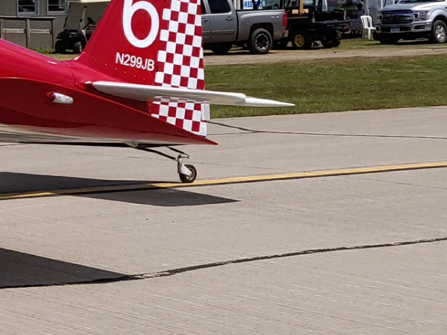

Originally Posted by RV8JD View Post
Yes, shimmy is an instability phenomenon which involves an adverse coupling of modes, like flutter is. And like flutter, not always intuitive. My shimmy experience is limited. See this article beginning with the paragraph "There are many types of tail wheels out there."
I think Van's design is adequate for Van's standard setup. But it may not have much shimmy margin for modifications or changes that deviate from the basic design and geometry, or for wear and the resulting freeplay that occurs.
Although tailwheel shimmy events on RVs are very few and far between, they seem to occur with non-Van's parts. I had two bonafide shimmy events with the Condor2 fork, hub, and 8" pneumatic tailwheel tire, which I documented in this thread. I have since gone back to the standard JDAir full bearing TW setup with the 6" tire. Post #21 in that thread summarizes my thoughts (I never did go back and try the steering arm as I suggested in that post). That may have worked, based on other's experience).
And "Airzen" had a couple of shimmy events documented here.
Usually (not always) some damping is good. (would have thought the pneumatic tire would help?). Stiction is bad (if that is a word).
Another thing I have found on a couple of RVs that were squirrely was that the attachment block was loose on the spring rod with play in the two bolts. Replacing those with taper pins tightened everything up and solved the issue in each case.

Originally Posted by scsmith View Post
Ed, what you describe sounds like the lower end of the pivot axis is forward of the upper end of the axis. So can you clarify what you mean by 'shaft pointed forward'? It seems to me that if the upper end of the shaft is forward, then the weight effect will help keep the wheel straight.
Yeah Steve,
That's exactly right. The top of the shaft was aft of the bottom end when on the ground. Sorry if I spoke confusingly. You're right, if the upper end of the shaft is forward the wheel will tend to want to follow the plane which is a good thing, though some report shimmy. It was originally mounted parallel to the aft fuselage bulkhead which would be perpendicular to the ground in level flight, but with the tail on the ground the bottom end of the shaft wound up well forward of the top end. Taxiing was a real struggle. The tailwheel kept trying to get in front of the pivot and it would take a bunch of power and braking on one side to get it pointed the right way again. You had to get it to lift the whole aft fuselage as it came around. We stopped the plane and actually picked up the tail so we could straighten it out a few times before we concluded we had to fix it somehow. As I said, once we got the shaft vertical as it sat on the ground, it tracked perfectly and was the easiest thing in the world to taxi with no tendency to shimmy at any speed.
If I had to pick between the 2 pictures posted by RV8JD, I'd take the #1 picture labeled bad tailwheel geometry. The #2 picture labeled good tailwheel geometry is exactly what worked very poorly for us.

I have the jd air tailwheel. It had negative camber and was hard to steer. I pulled the tailwheel stinger, put a 9deg bend in it and stood the tailwheel pivot axle up straight. It is like power steering.

Post 23 is how the pivot point should be and the simplest way to correct improper angle.
Just one quick note for clarity... that is actually one of our Screaming Eagle tailwheels, slightly different from the JDAir fork.
It's fairly common for these Van's springs to take a bit of a bend over time, as many folks here can attest after the tailwheel strikes the fiberglass on the bottom of the rudder. This is the first one I've seen bent the opposite direction... if anyone else is considering doing this, just make sure you do it safely! I imagine you'll be putting quite a bit of pressure into a pretty stout spring, so you had better make absolutely sure it doesn't break free in the process!

My stinger was laser straight before bending. The 9deg bend was with a harbor freight pipe bender with the smallest die installed. I bent it cold. I used the tailwheel hanging weight on the end to ensure it was plumb. Overbent to 12 degs with spring back to the desired 9 degs. Worked like a champ.
