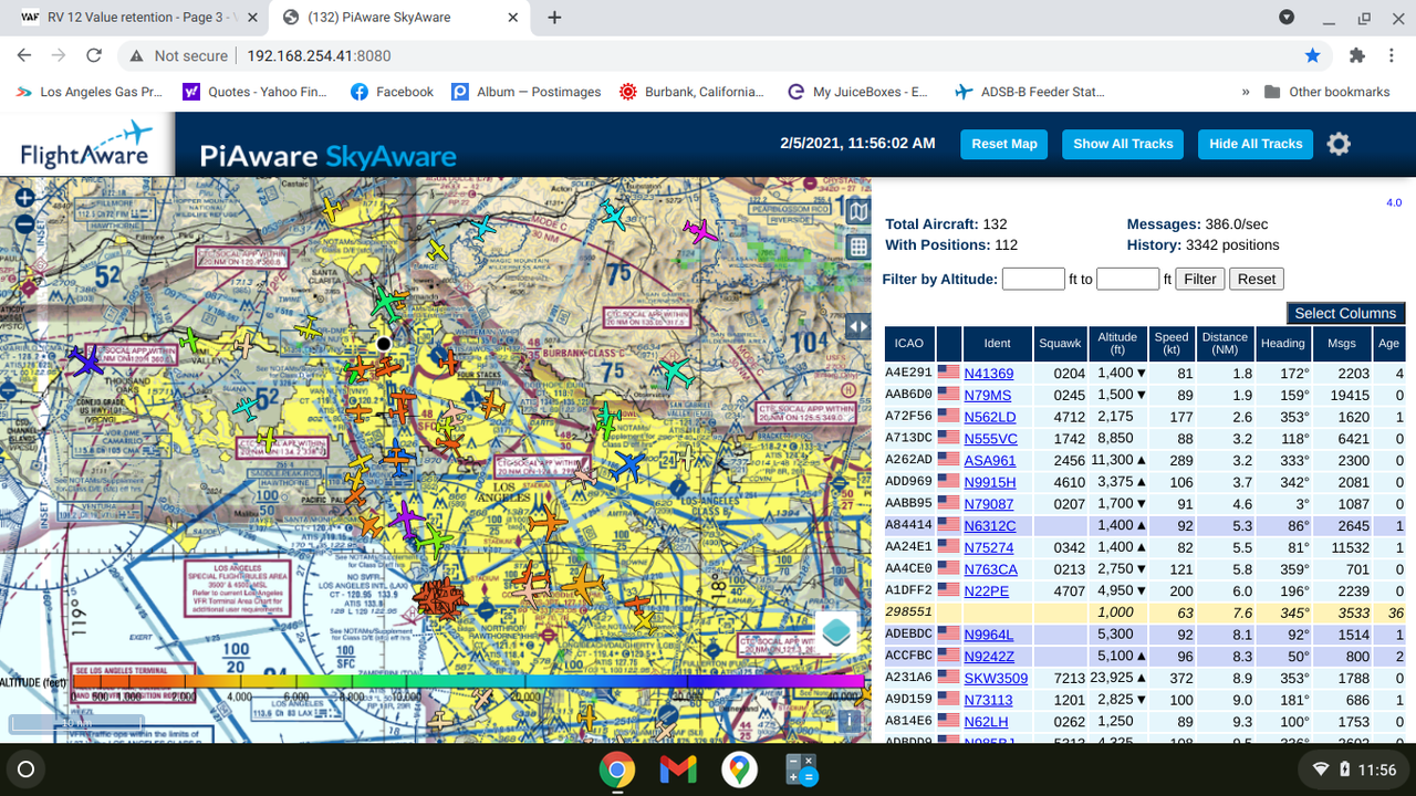

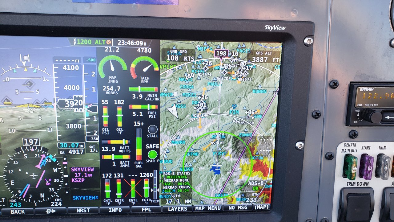

There were a lot of RV-12's out there when I was looking, with low hours, under 100, with years of Van's required "25 hour" inspections for cracks, and none of the service bulletins "updates" performed, installing backers or doublers, in a lot of areas that need it, that newer build planes incorporate into the build. Those are real time eaters, or money eaters, if you have to pay someone else to do those SB updates, and document the updates. If you have the skills and time to do it, great, if you just want to buy a plane to go fly... it might not be such a bargain to have to pay someone to do all the time intensive SB's to make your new build "current". That's heavily reflected in the price asked.
The 2012 I bought already had all the updates and all the hard, time consuming or 4 or 5 project rivet drilling reinforcement backers and reinstalling SB's performed. I feel I got a very fair deal for only 168 hrs on everything. Plenty of time for all the bugs to be worked out. New Voltage Regulator, new PC680, fresh new back up batteries in ELT 406 and Skyview, new brake pads. Previous owner was pretty meticulous.
All I had to add was new tires and tubes and install a GPS 2020 ADS-B out antenna, my plane is based under a mode C 30 mile veil of KLAX.
For where I live and fly... anything that didn't have at least a Dynon Skyview, and ADS-B in and out with the ADS-B 2020 antenna, was not a consideration. Installing a newer instrument panel and associated costs, made the early versions not suitable. These were most Rv-12s with a 2012 or earlier Airworthiness date. I didn't want the Dynon Flightdeck D180 and Garmin 396 GPS package. It wouldn't work very well flying anywhere pretty much around most of California, we have congested airways.
This is why ADS-B In is so valuable for situational awareness, for me. Easy to glance at on the screen, and helps you pick up those you are having a hard time seeing.

ADS-B IN is pretty nice too, if you want Rain, Pireps, plane location reports flying in your vicinity, current weather conditions at airports, Green, Blue or Red showing at towered airports, as well as current TFR locations to avoid, such as during fire season on the West Coast.
