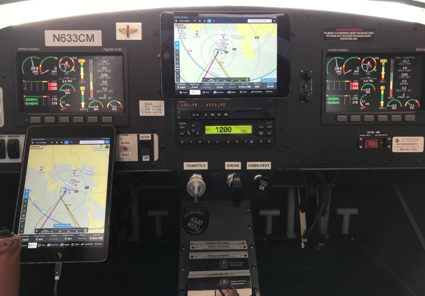

Frame question: How important is it to get exactly a uniform 7/16th gap between the front bow and the panel?

If it?s the clearance I think you are referring to you want to be sure there is no interference between the bow and instrument panel when closing the canopy.

I have just enough clearance to mount mini iPad with thin 3M Body Side Molding Tape at top of radio stack. Canopy bow covers top portion of iPad but doesn't hinder full view of screen.
Thanks, guys. My gap varies across the width of the airplane +- 1/16th. I guess I'm worrying about trifles.
