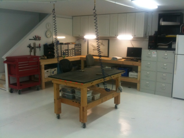

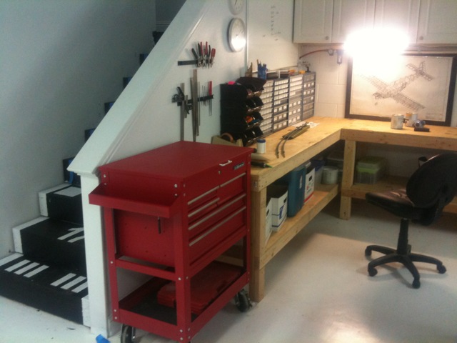

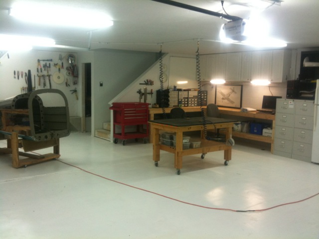

I have just recently finished building my new house and thought I would share some workshop photos with everyone. This is the 3rd and final workshop that this 10 has seen in the past 2 years.

Awesome job on the shop Sean. What floor is that? Tile or epoxy?

The floor is just your basic off the shelf epoxy garage floor paint from Lowes. I sealed/primed concrete first. Four coats of white after that. Finally, I topped it off with a clear gloss epoxy with a traction additive. The floor turned out pretty nice and the price was under $500 for over 1000 SF DIY.
I few things that my previous workshops didn't have that this one needed in my opinion.
#1 A separate area for the air compressor. I used the under stair space for this. I have a dedicated 20A circuit just for the compressor (NON ARC fault). It is a large area that is sound insulated and will not overheat. This is my Favorite upgrade! I can talk to someone while the tank is filling :)
#2 Surface mounted air supply hoses in strategic areas. I'm gonna love this.
#3 More EAA type wall tables. I added 2 8x2 tables. This has given me designated areas for planing, storing, grinding, cutting, and assembly.
#4 My Computer. One of the best additions. I never thought it would be so handy having the computer right there.
My garage is just over 1000 SF and my wifes car gets it designated area every night now. My dimensions will allow me to assemble everything from tail to spinner (less wings of course). I am hoping this makes the on field assembly time much easier.

Another Rudy Greyling Award Winner! Shop looks great and spacious it's about time to get lots of aluminum shavings and fiberglass dust on that nice floor. Do you have enough lights? It looks like you have strategically placed fixtures over your tables but what about the general area? I have six large fixtures for half of your footage and would like to have more.
Hmmmm
What I like is the two clocks. I'll assume one is on local time, the other on Van's support staff time. :)

I can't tell for sure, but I ASSuMEd the bottom one was a thermometer. I have one in my garage/shop to give me an idea of when I can paint, or how long the proseal will remain workable.:eek: A second clock would be a great idea, but I'm already in the same time zone as Van's.:p

Way to clean! Mine started out nice and clean like that. Lasted about a month then I gave up on cleaning and concentrated on working. I think you need more lights!
