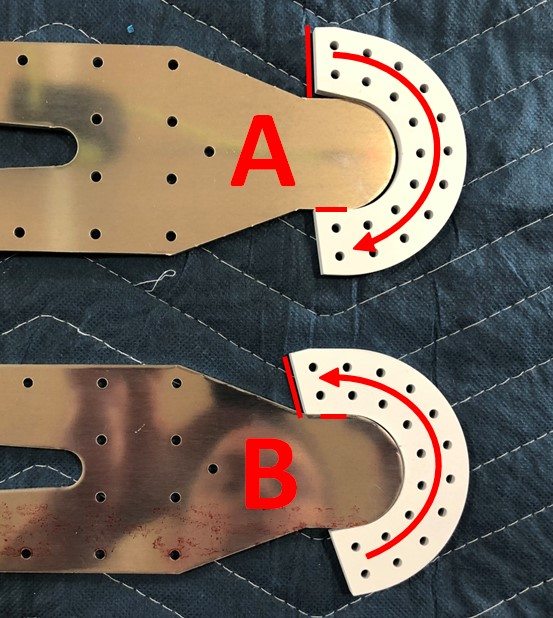

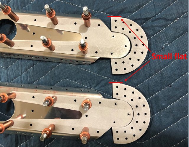

Ok, so I think I've convinced myself that I've got this right, but want to double check before filing away...
I believe the parts are in their correct orientation in the top part of the pic below, correct? (It just gave me pause that at first glance they seem to fit better the other way around, at the bottom of the pic.)
Next, is how to determine the relative angle between the two... I'm thinking the small flat on the inside bottom radius of the F-1206C receptacle should be co-linear with the bottom of the stub spar assembly? Makes sense from a gravity on the ground standpoint, when installing the wings, but under loading they'd want to go the other way, so just want to be sure.
Small Flat
The orientation of the small flat is in the plans. Unless I?m missing something what?s the issue?
Looking at the plans, I think I see what the problem is. The parts on the left are the W-1208B stub spar doubler and W—1208C stub spar channel. The part on the right is the F-1206C rear spar receptacle.
The stub spars attach to the F-1203C stub spar receptacles, not the F-1206C rear spar receptacles. See drawing 21iS/U 13 for F-1203C. It has a bevel to indicate the top of the part. The W-1207B rear spar doubler plates attach to the F-1206C receptacles.
Drawing 21iS/U-01 provides a good overview of both receptacles in relation to the entire mid-fuselage assembly.
Looking at the plans, I think I see what the problem is. The parts on the left are the W-1208B stub spar doubler and W?1208C stub spar channel. The part on the right is the F-1206C rear spar receptacle.
YES! That's it, thank you!! Lol

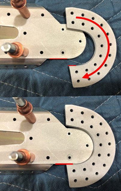

Now that I think I've got the right parts, the rotation question remains...
The spars don't appear to have a top and bottom at this point, but they can still rotate within the receptacle.
So do I file the spars to fit orientation A or orientation B? (I think it's A, but you can see they already fit quite nicely in B, so I don't want to screw it up)
Now that I think I've got the right parts, the rotation question remains...do I file the spars to fit orientation A or orientation B?
That's the part of your original question I was wondering about, too. If you don't get an answer in the forum, let us know what you learn from the factory.
Response from Van's:
The angle at which these two interface is predetermined by their relative positions/orientations in the airframe. Your positioning ?B? look better but is probably turned a little too much and should come back a little.
I basically split the difference and it ends up fitting through a good portion of the rotation.
