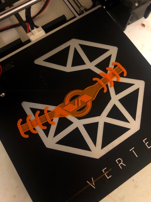

Originally Posted by greghughespdx View Post
Super cool stuff! If anyone has any tips or tricks for settings and getting good prints, please share them!
We reduced cycle time from 17 to 11 minutes by extruding more plastic. changed print width from .6 mm to .9 mm. the straps are fully functional and just as strong. material is ABS. bed temp = 100C. nozzle = .5 mm. no glue on the bed to keep the parts clean.
probably the most important thing you can do is have a calibrated machine. make sure these two things are calibrated before each print or at least at a material change: feed rate from the nozzle (the 100mm test), compensate feed rate for filament diameter (measure filament diameter and set parameters to compensate flow volume).

Originally Posted by Steve Melton View Post
we returned and redoubled our efforts to reduce the print time from 17 minutes to 11 minutes with 99% of the quality. we should be able to output a couple hundred per day.
Steve, our group redesigned the ear saver to reduce print time to 6 minutes... I can do 7 in 42 minutes or 10 in an hour (depending on the layout, i'm having better success with the 7-item layout) on my Prusa Mk2.5.
Here's the pattern: https://github.com/bccovid-19/printf...small_V004.STL
Rob Prior
  #40
Old 04-11-2020, 10:23 AM
Snowflake's Avatar
Join Date: Oct 2009
Location: Sidney, BC, Canada
Posts: 4,079
The recommended settings we're using in the BCCOVID-19 site seem to work really well: https://github.com/bccovid-19/printf...er/Ear%20Saver
As much as I like the intent behind the "branded" ones (the VA one looks pretty cool in two colours like that), it's been pointed out that it takes longer to print them (so less get made), makes the center of the strap more rigid and less comfortable, and as this is about freely supporting the community nobody should be using it as advertising space. Our group is asking printers to not apply branding.
