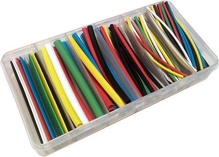

As to white wires-----------
I bought an assortment of various color shrink tube like this.
http://www.amazon.com/Length-Heat-S...457458077&sr=1-11&keywords=heat+shrink+tubing
I cut a short piece and use it on either end of a white wire to identify the wire, sometimes use two color bands if needed for larger wire bundles.
Make notes on your schematic drawing for later identification.
