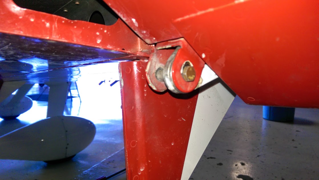

Hi all,
I discovered that the inboard right aileron hinge has elongated holes and probably needs to be replaced. Here are the photos (sorry for one that is out of focus).
http://goo.gl/ZNFXvO
http://goo.gl/i7dGc8
Does it need to be replaced? It looks to me like it does, since there is significant play in the right aileron at that hinge.
I bought my plane flying so I have no recollection of building this part. Is this A-1007-R-PC ?
Thanks!

The pictures are made from under the right aileron, looking at the most inboard aileron hinge. The right aileron is fully deflected up so in the top left corner you're looking at a flap inside.

It is the A-1007. The rod end attaches on the upper end of this bracket, the elongated hole is the hinge pivot point.
This definitely needs to be addressed. There is a spacer missing besides the holes being elongated, and I can't tell if the bearing is there or not. Any "slop" in the hinges has the potential for causing flutter.

I would replace the A-1007-L (or -R). Call Vans and order one. It is bolt on.

If the aileron can be moved vertically, or horizontally on that hinge, I would DEFINITELY ground the airplane until it is repaired. In other words, if there is any slop in any direction.

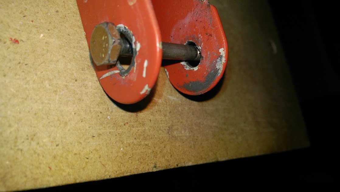

I removed the aileron today and uninstalled the bracket. Here is a photo of the bracket with the original screw inserted for reference:
http://goo.gl/dk1Xhq
Not nice. Not nice at all.

I am sure you looked at this but it looks like the bolt was too long or lacking washers to prevent nut from bottoming out on threads.

The question is how could this happen? I doubt the builder enlarged the hole, so it must have been an incorrect bolt I guess?
My guess would be that the bolt has been loose for a while.
Either because it was too long and the nut was bottomed out, or it was never fully torqued.
As already mentioned (I think?) it could be the correct length bolt but incorrect spacer length..... the bracket looks as though it has been bent/deformed and the two sides are no longer parallel to each other (though that could be an illusion because of the photo angle). This could have been done when the bolt was torqued with too short of a spacer.

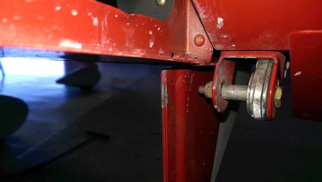

Anyway, this issue is now fixed. Here is the aileron hanging on its new bracket:
http://goo.gl/J8x89d
And here is a comparison of old vs. new:
http://goo.gl/aoyGkV

In looking at the second photo showing the comparison between the two brackets, it appears that the bolt holding the bracket in place is too short. I can't see at least two threads sticking out beyond the nut.
It could just be the angle that the photo was taken, but I wanted to call it to your attention. Better safe than sorry.

I agree (though the standard minimum is one full thread).
I triple checked today, both screws have exactly two threads sticking out, counted with my nail.

It sure doesn't look like there are any threads protruding beyond the nut.
Yes, it's a bolt. Sorry for a mental shortcut. I'll see if I can sneak a photo from the other side showing the threads. Unfortunately, I don't have a borescope (or dental) camera which would make this task easy.
Is if possible that the pic was taken before the nuts were tightened down? It looks like a gap between the parts.
Also, in the other pic there may be too many threads showing. Just make sure of this otherwise the bolt could actually be loose in the fitting and your problem could come back.
Ah, of course, "old vs. new" was taken before tightening. There is no torque seal on it. Sorry, I am being paranoid about this. Triple and quadruple checking is way better than the alternative. Thank you so much for the pointers.
Here is the pic of a bolt after tightening:
