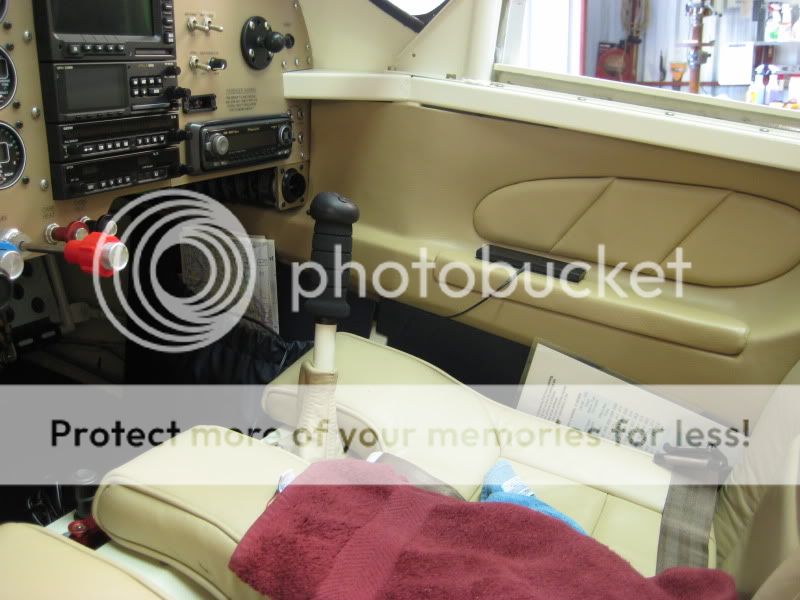

I guess I should chime in here. I am doing the testing for Don. I mounted Don's antenna on the belly of my RV-6. I removed my tracker antenna for the new antenna and borrowed the tracker's RG-400 coax.
The Wilson amp uses a power supply that plugs into a cig lighter outlet. The RF output of the amp goes to an "inside" antenna that should be positioned near the cellular data receiver: in this case, my 1st generation iPad. The amp has three green lights on it: the first indicates that it is powered on, the second indicates that there is throughput of the lower frequency cellular signal and the third light indicates throughput of the higher frequency cellular signal. So, if you have 3 green lights, everything is working properly.
So far I am impressed with this setup. Like many of you, I have experimented with the 3g data on my iPad below a couple of thousand feet and found it to be adequate but intermittent. So I was quite impressed when I was receiving data today at 9,500 feet. On a previous flight, I was receiving data up to 6,500.
I would emphasize that I have a long way to go before I can have a definitive opinion about this system, but initial results are very promising. I am getting 5 bars (the maximum) at 9,500 feet along with the AT&T logo and then the 3G and the hourglass indicating that it is receiving data. Occasionally, I get an "E" instead of the "3G" which I guess indicates an older technology network than the 3G. It does lose lock quite a bit: one minute you'll have 5 bars, and then nothing. But the data appears seamless to me. Even though there are a lot of interruptions, the data seems to continually update. I tried getting the weather at KSFO, for example, while at 9,500 and had no problem getting the entire SFO package, including NOTAMS, winds aloft, METAR and TAF. It comes in very quick.
On my last flight, I was playing around with the radar map and although it received data fine, it appears the bit rate is not high enough to enable the loop function. So what you get is the last 5-minute snapshot of the radar return and it updates approximately every 5 minutes. Of course it is time stamped so you know how old the data is.
I can easily envision flying along on a cross country and being able to look ahead at the weather without any problems--at least this has been my impression so far, but I want to use the system quite a bit more to see just how reliable it is going to be.
I will update my findings as I go along and post some pictures in my next entry. My hope is that this will be another use for the iPad in the cockpit: already it has proven to be very useful to me as an EFB.

Here are the pictures of the installation.
Don's antenna is the rearmost. It is actually the same size as the transponder antenna on the right.
I have the amp just sitting on the floor for now, but it can easily be velcroed to the forward side of the wing spar. The ON/OFF switch for the amp is on the cig lighter plug and has a red LED in the switch to indicate when the switch is on. There are also three green LED lights on the unit, barely visible here.
This the interior antenna. It comes with velcro attachment tape. I have it just sitting on the right arm rest for now with a piece of painter's tape until I decide the best place to mount it. You can also see the cig lighter plug/switch just above the red fuel selector on the center console.
