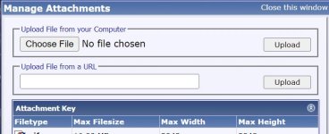

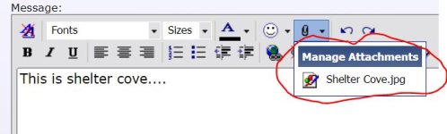

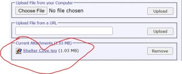

Originally Posted by Dad's RV-10 View Post
Your first Dropbox link is broken:
Attachment 27212
Attachment 27213
Attachment 27214
https://www.dropbox.com/s/oclb67lz8l...65905.jpg?dl=0
