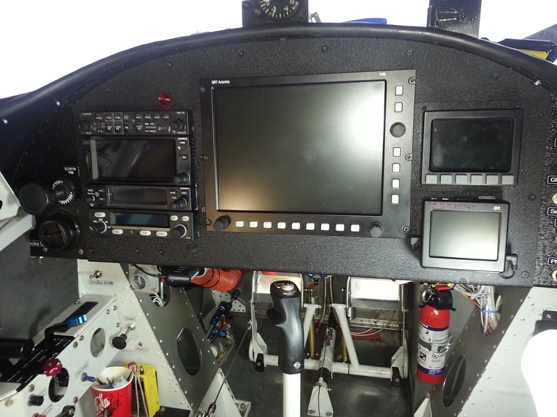

Well, the "Need" to have a WAAS GPS and 2020 compliant panel pushed me over center and I decided to bite the bullet and upgrade all the COM/NAV capabilities in my 8.

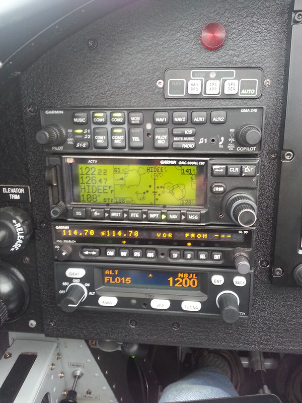

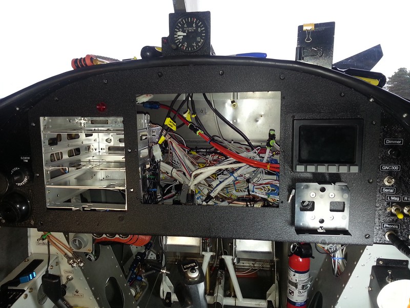

I had a nicely equipped IFR panel that had almost everything but a Certified WAAS GPS. I could do ILS/LOC, VOR and GPS approaches, but not the LPV's that are replacing the old ILS systems. Also, I have ADSB out, but it wasn't compliant since I didn't have a certified WAAS signal to feed my position.
This is what I started out with.

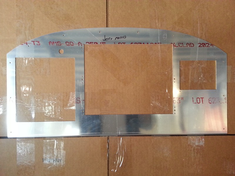

To start the process I got on the horn with Stein and resupplied his .02 cent supply. I also had a panel blank shipped to him so he could have his guys cut it out and I knew if I gave him the proper placement I wanted, the dimensions of the cutouts would be correct. Here's what I got in the box from him.

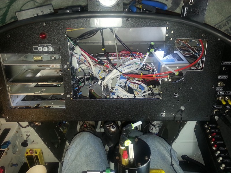

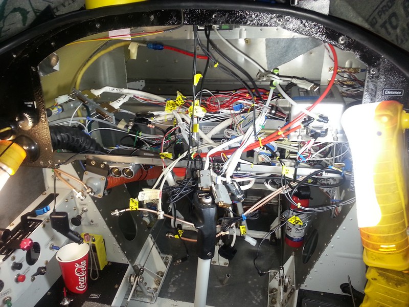

To start the actual project I removed the existing panel and equipment and started tracing wires. I am using the Approach Faststack hub system so mainly I have to change the cables they provided and reattach the power/ground/lighting wires. Still, once I undid all the cable wraps it looked like someone threw a hand grenade into a spaghetti bowl.
After removing Cable ties

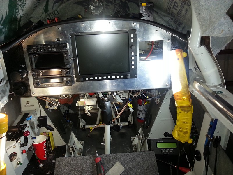

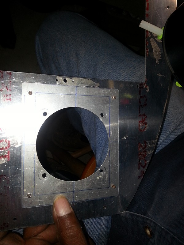

While I was figuring out the wiring situation, James Clark was busy fabricating a plate to put over the hole that was cut out of the panel to accomodate the new GRT Mini B that is forthcoming. I put the venerable Dynon D10A back in this spot until the Mini is shipped towards the end of this year. James made the plate to fit the #4 nutplates required for the mini B so when it comes it'll be easier to install.

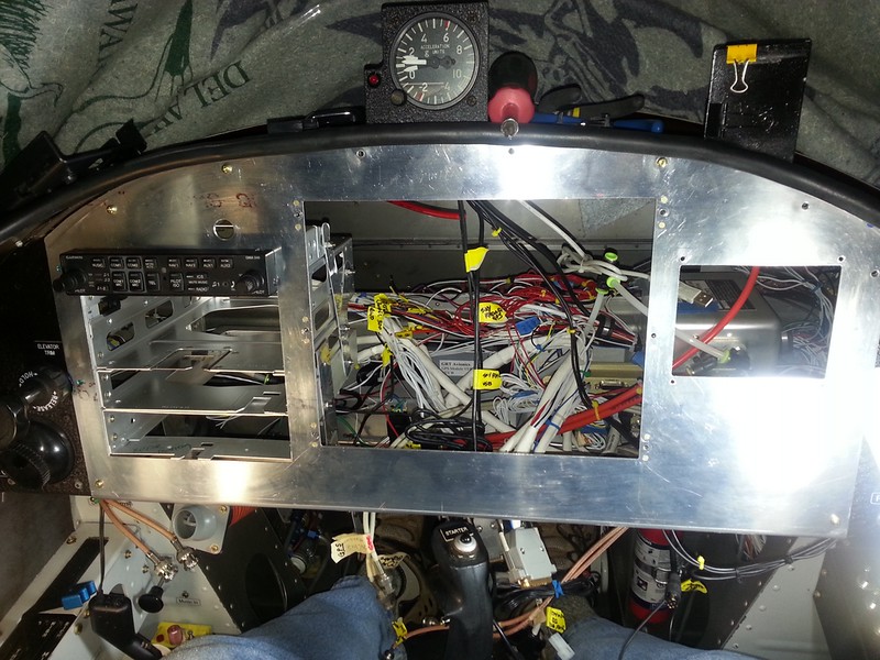

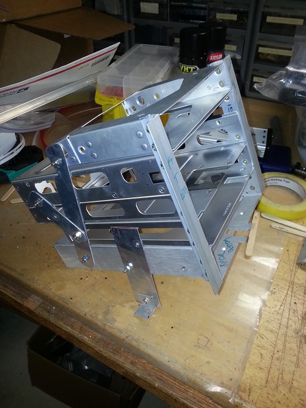

Next I had to rebuild my radio racks to take the old out and put the new in. Once I mocked these up we placed them in the cutout of the new panel and they fit perfectly. Thanks Stein and CAD..
I just had to have a peek at what it was all going to look like, call it a test fit..

Once the panel blank was prepped and all the required holes were drilled we mocked everything up to see if it all would fit.

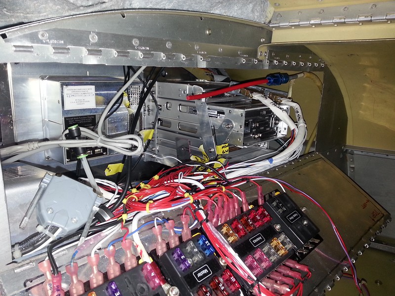

Now I had to get back to work on the wiring side of things. Using the hub system made it go quickly. I had to pull all the existing power and ground wires from the blocks and mount the backplates to the radio racks. Then we mounted the complete set of racks and cables in the plane so I could start running wires.
Another couple hours connecting wires to power and ground blocks and connecting plugs to the Faststack Hub and I could start tidy'ing things up.

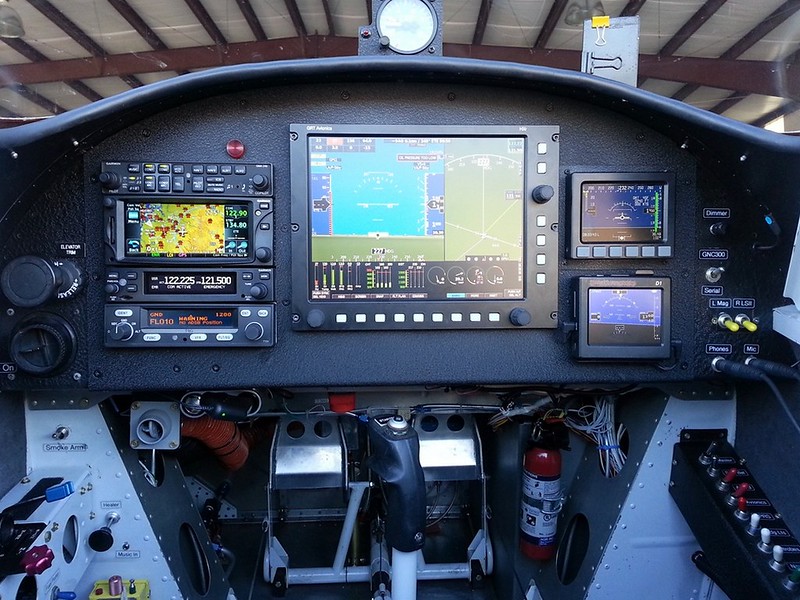

Now was the big moment. Would all the smoke stay in the wires? Slid all the components in and powered up individually and everything appeared to work.
Now it was time to install the panel which I painted the night before and all the Wrinkle paint was properly wrinkled. Had to drill a few holes to mount the D1 and position all the cables and hook up all the antenna's. Speaking of antennas, James made a nice mount so I could put the GPS antenna under the cowl and not have to run new RG400 all the way to the rear deck where the old GNC300 antennae was. I hate running wires to the back of the plane..
Everything fit perfectly!

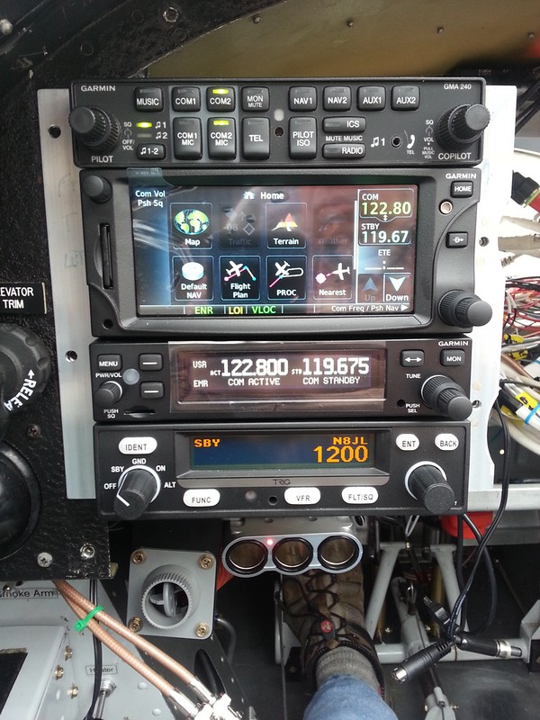

I had the old system tweaked perfectly. Everything on everything worked great. Getting the 650 setup to talk to the HXr and the XPDR was just time consuming. GRT has a nice supplement explaining the setups for both items. The wiring diagram that I got from Tim Haas at Faststack laid it all out in plain English to James and his fingers danced over the buttons faster that I could watch and ... like magic, magenta lines drew, courses appeared and numbers spun in the ARINC counters in the HXr..
Now, everything is mostly rosie..
There were a couple surprises and they both came from Garmin. With the SL30 I could remote tune and switch and monitor freq's in the HXr and switch back and forth. Both COM and NAV. Not so with the GTN650. Evidently, it doesn't transmit out the info that GRT needs to read what's going on in the radio so I lost my ability to remotely switch the freq's in the 650. Same for the 200. It will receive 232 data from the HXr so I can set the freq and send it to the GTR200, but it doesn't xmit the required data out back to the HXr.
This is no biggie, just a disappointment that I lost a really nice feature of the GRT equipment in an upgrade.
The HXr won't display all the neat features the 650 shows such as holding patterns and early turn points at course changes. Again, not a big deal, just would be nice to see on the big screen.
All in all, I excited to be flying behind a state of the art panel in my Home Built airplane.. amazing!
Color me a happy camper..

GTR 200 Serial Out
Hello Jerry,
You might want to check your wiring because the GTR 200 does indeed transmit similar data to the SL40 out pin 23.
Refer to Appendix B in the GTR 200 installation manual for information regarding the serial data that is transmitted by the GTR 200.
You might also check that your GTR 200 has the latest software since we have made some minor improvements in the transmitted data. As you probably know, the software can be easily upgraded by the owner using the front mounted micro SD card slot.
Thank you for installing these Garmin products in your panel! Please contact us by phone or email if you have any questions.
Steve

Thanks Steve.
We **assumed** that the 200 would understand "SL30/40-speak" and were surprised when others thought it didn't. I just read through the protocol and see that it's capable of "multi-dialog-speak-and-hear". :)
I **assumed** that the GTN 650 would have that "old" functionality as well. :)
Did we miss that somewhere????
James ... Widget's helper. :)
