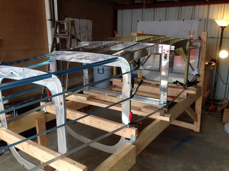

Am I on the right track? nothing is riveted, need more clamps and still need to square it all around.
1. When i get ready to drill holes to start securing it, do i place a few skins on to make sure it aligned, or do i trust the measurements and drill and cleco? Are the skins able to trimmed?
2. I destroyed a F602R, what is the easiest way to get a replacement?

To answer your question, you trust your measurements and then drill holes for assembling the bulkheads, stringers, etc. Do yourself a favor and drill the holes a bit off-center and use small flat head rivets to secure the skeleton together. That way, when you put the skins on, you can have a rivet dead center in the intersection formed by the bulkhead and former. That's not necessary, but I like the effect better.
