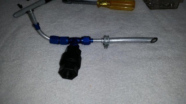

Reposting what I do.
I worry about two things for tank vents:
- Mud daubers
- Ice
Either one will block a vent which could lead to tank collapse.
Here is a mod I did for the RV-10. Note:
- The piece out in the breeze is 3/8” tubing, cut on a bevel with a piece of aluminum screen JB welded across the bevel. This is for the mud dauber risk. The 3/8” tubing bevel cut provides more surface area for the JB Weld.
- The black nylon thing is a vacuum breaker suitable for fuel use. It only takes a few inches of vacuum to open the valve. Here if ice forms on the outside piece you suck in are from the wing root area. I never had a problem with fuel leaking past the valve.
The valve is very light and available from McMasters.
Carl

Would you have a part # or a link from McMasters?
