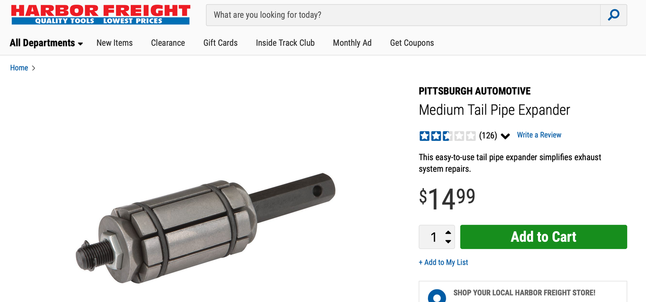

Someone in a long-ago thread suggesting using a muffler pipe expander to align the spar bushings. For what it?s worth?
Hi all a quick update. I've tried everything I can think of with the left wing (trimmed the bottom skin a tad, took the plastic stop block down maybe a 1/6th and as a last resort took the aft stub spar down maybe a 32nd, it seemed to be bottoming out before the front one.) I've tried ratchet straps (really tight), pushing, rocking the **** thing and it's still way to far off. I don't know how but I must have screwed something up, but I have no idea what. Everything I measure and double checked seems fine the Fing thing is just not going in far enough. Ironically the right wing fits like a champ with almost no effort (pins slide right in).
I sent an email to vans and will wait to see what they say.
Is it still off by 1/4" - 3/16"? If so, the exhaust expander probably won't help. I use it for just the final minor line up of everything.
