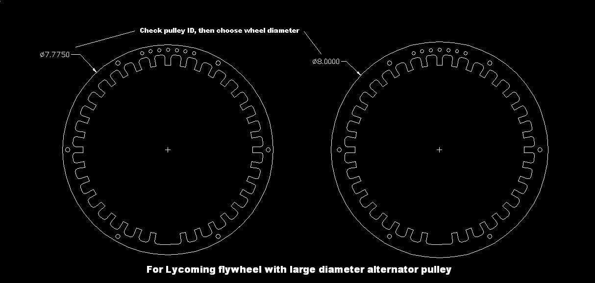

A toothed wheel inside the pulley makes more sense.
Here are some bolt hole dimensions for mounting an inside wheel to the larger pulley that I lifted from the Lightspeed site :)
4&6 cylinder bolt orientation in relation to the missing tooth would be 30deg. different as shown in the pic
If the wheel was made with the teeth on the OD (the same as a car) and the reluctor was mounted clock wise 90deg. from the TC mark there would be plenty of room to mount the reluctor with a bracket mounted on the 2 crankcase through bolts similar to Ross & Robert's design shown in this photo.
The ID of the wheel would just have to be bigger than the crankshaft flange to allow it to slip over in one piece. My verniers are not large enough but I think the crank flange on my engine is somewhere around 6"or so.

Feel like drawing something up for us Dan? I don't have access (or the knowledge) to do a CAD drawing for it.
Sure. This would be the 4-cyl orientation, slip-over-hub style. A variation would be like Bob's 60-tooth above, a split ring with additional tooth support.
No warranties gentlemen. You're welcome to a .dwg file, but it's your project. Check dimensions, output waveform, etc.

You are a true Gentleman Dan. Thanks :) I would love to have a copy of the file for it.
I will send you a PM with my email address

I had an inside ring for the large pulley made yesterday at the local Water Jet shop.
It was easy with Dan's Cad drawing :D I did have them increase the OD to 8"to allow enough meat on the edge for me to countersink the holes for 8/32 screws. Made it from .125 Mild Steel. It cost me all of $37 :)
Will probably get it plated before fitting.
Here is a test fit on a flywheel I found lying around. The hole centres line up right in the middle of the flange bosses and it has just the right amount of clearance from the radius on the inside of the pulley.

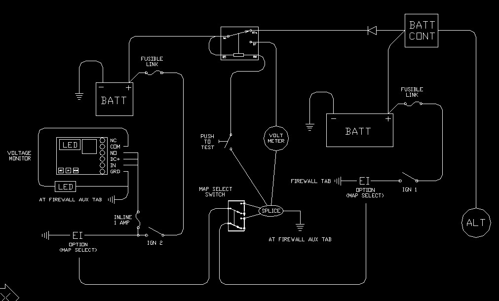

If I understand this system correctly the EDIS is capable of running without the ECU/Megajolt and will fire at 10 degrees BTC. If one were to position the pickup so that corresponds with 25 degrees BTDC on our engines failure of the Megajolt in cruise is almost a non event.
One Megajolt is also capable of firing multiple EDIS units. So it is reasonable to build a dual ignition system with one Megajolt and two EDIS units? It may actually be preferable to reduce programming requirements etc.
Presumably the EDIS is a CD ignition, and would compare to the PMAG in terms of spark energy and duration?
Has anyone measured the current requirements of the system to size an appropriate backup battery?

Diagram (updated 2018):

Nice, easy to follow, wiring diagram, and simple is the operative word. For the backup battery the diagram shows it connected directly to the main battery negative post.
If the shared positive connection at the master solenoid fails, you have that 3.8ah left to get you on the ground, but it something should happened to the main ground connection, or the main battery itself, you could potentially lose both systems. I think it would be possible to ground that second battery to separate ground, eliminating a single point ground failure? This might cause a ground loop problem for your radios but at that point you are just trying to get on the ground.

If the shared positive connection at the master solenoid fails, you have that 3.8ah left to get you on the ground....
Should have both batteries and two ignitions...unless the solenoid end of that positive cable breaks off and shorts to the airframe, discharging the big battery (and probably melting some aluminum). That particular failure mode is a possibility with any airplane, so we go with robust terminals and good wire fixation. I make mine from welding cable and lugs, because I like the flexibility.
.... but it something should happened to the main ground connection, or the main battery itself, you could potentially lose both systems.
That's a real risk, although again, we're talking about robust components. The EDIS/Megajolt grounds run to the adjacent single point fast-on panel inside the firewall, which is linked to the rear batteries with a #2 welding cable. Baring terminal breakage (again HD welding lugs) the disconect risk is one of nuts or bolts unwinding, one at the single point ground, one at the main battery negative terminal. Not too concerned with the 5/16 stud up front. I might drill the heads of the battery bolts and wire 'em. Right now they're 6mm with split washers.
One possibility might be locating the little battery in the front, near the modules, for a easy direct connection. Or I could run an individual ground wire back through the airframe for each ignition. Here I've elected to rely on the big cable, which raises the classic "single point of possible failure" question; how robust must it be to consider it safe enough?

On the single ground issue, perhaps he meant that as drawn, the battery negatives are tied together and then a single wire goes from a negative terminal to ground. If each battery has its negative tied to the chassis, then losing one ground leaves the other battery still active. That might be how it's actually wired, but it's not drawn that way in the image.
FWIW...
On the single ground issue, perhaps he meant that as drawn, the battery negatives are tied together and then a single wire goes from a negative terminal to ground. If each battery has its negative tied to the chassis, then losing one ground leaves the other battery still active. That might be how it's actually wired, but it's not drawn that way in the image.FWIW...
No airframe grounds. It's a single point ground system, nice and quiet. Both ignitions ground to a standard "forest of tabs" ground point on the firewall, which is linked to the batteries via a #2 cable. Thus the classic debate...is a single high quality cable, with bolted connections at the ends (the red dots), robust enough to assume a very low probability of failure?
If you think not, the simple cure is an additional ground wire from IGN2 directly to the little battery's negative terminal. You won't get any argument from me. Might even talk me into it.
This may help (or maybe not).
Dan, I would highly encourage you to think of adding a second ground. And on top of that, check the battery connections regularly. It always seems like the corrosion starts on the negative terminal.
Vic
When I said 'airframe', I was referring to your forest of tabs location. Surely the forest of tabs is bonded to the airframe. What I was trying to describe is moving the 'white' battery negative from the 'green' battery negative terminal to the forest of tabs. If both batteries are in the rear fuselage, and the forest of tabs is at the firewall, I can see the difficulty in implementing that change.
I'm *not* saying what you've got in the drawing is unreliable. Just that if the negative connection to the airframe is near the batteries, it would be simple to make both battery negatives connect directly to airframe ground, and would achieve operational redundancy. If the 'white' battery doesn't participate in starting, perhaps running a smaller gauge negative wire to the forest of tabs would be feasible to get that redundancy.
