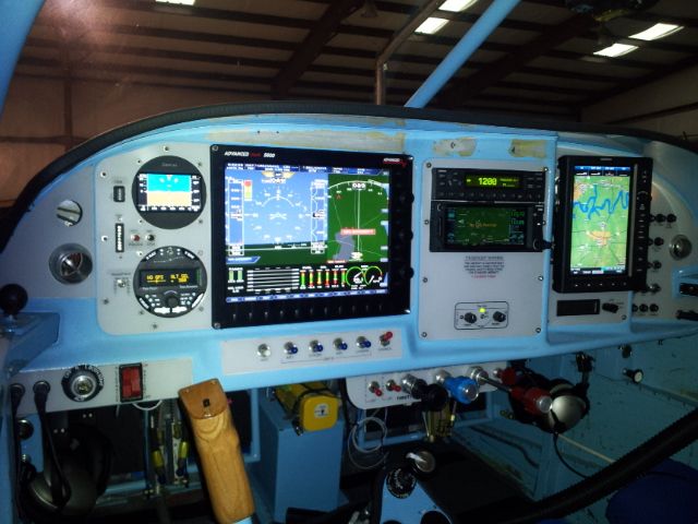

Here is N863JJ Finished in 2005 by John McMahon Galatin TN
Panel Just Upgraded
RV-6 O-360 CS 750 hrs and counting
