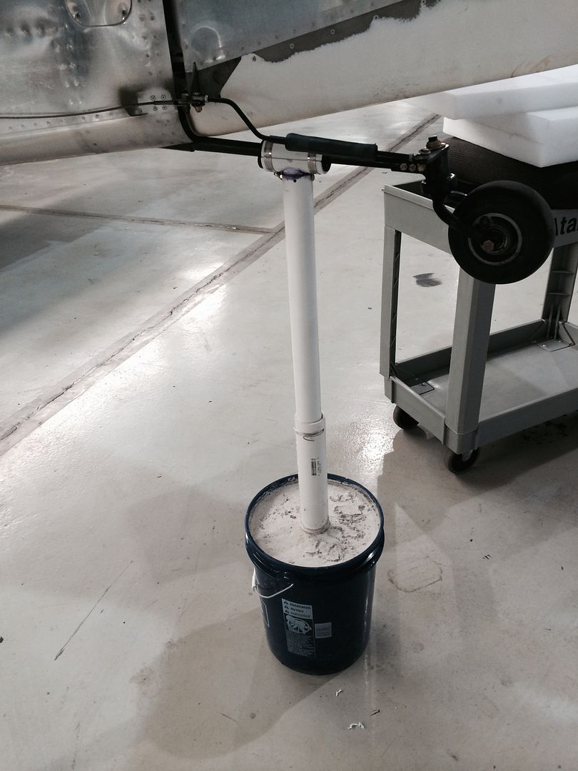

  #20
Old 01-13-2015, 04:25 PM
kinger's Avatar
kinger kinger is offline
Location: USA
Posts: 259
I can do tailwheel maintenance at the same time too.
