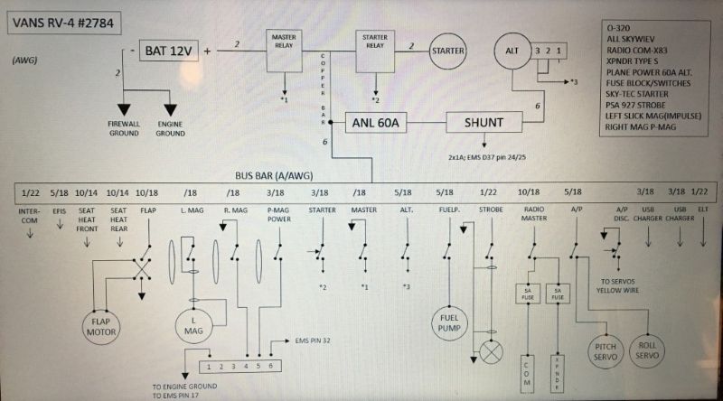

Yes, all DYNON but will only be day VFR for now. Struggling with photobucket but here's the electrical system, simple drawing in powerpoint but it makes sense to me Will try to make the EFIS planning scheme to be possible to share shortly.

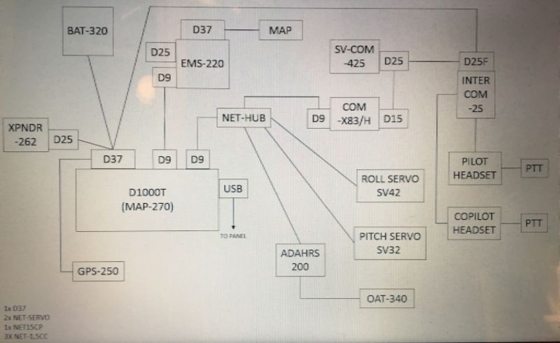

Got the preliminary registration number, the project is now named SE-XZT ELT is shipped for programming and I'm half way through wireing and terminal connecting. EFIS component layout:

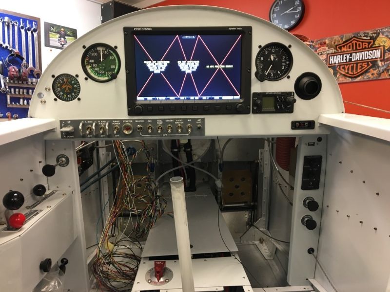

I got the fuselage far enough along, that we all got a chance to sit in it.
I have been working on the panel, forward skin, cockpit rails are drilled, roll bar is drilled, front seat is done, lots of stuff ready to prime.
Floorboards are done except for footwells. I am VERY close to ordering finish kit.
