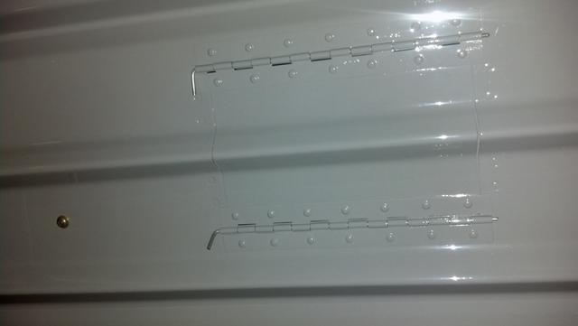

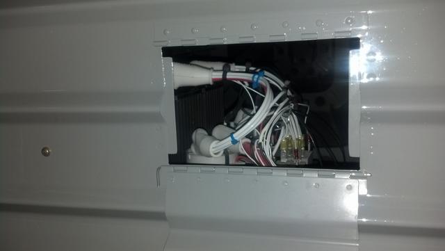

Here is a simple access door that allows visual inspection of the batteries, battery relays and tail cone. It comes in handy, but for any real work the lower bulkhead panel needs to come out.

I did not get extra material. A careful cut using a thin blade Dremel cut off wheel will allow reusing the cutout for the door. I added the side backing plates to restore rigidity.
