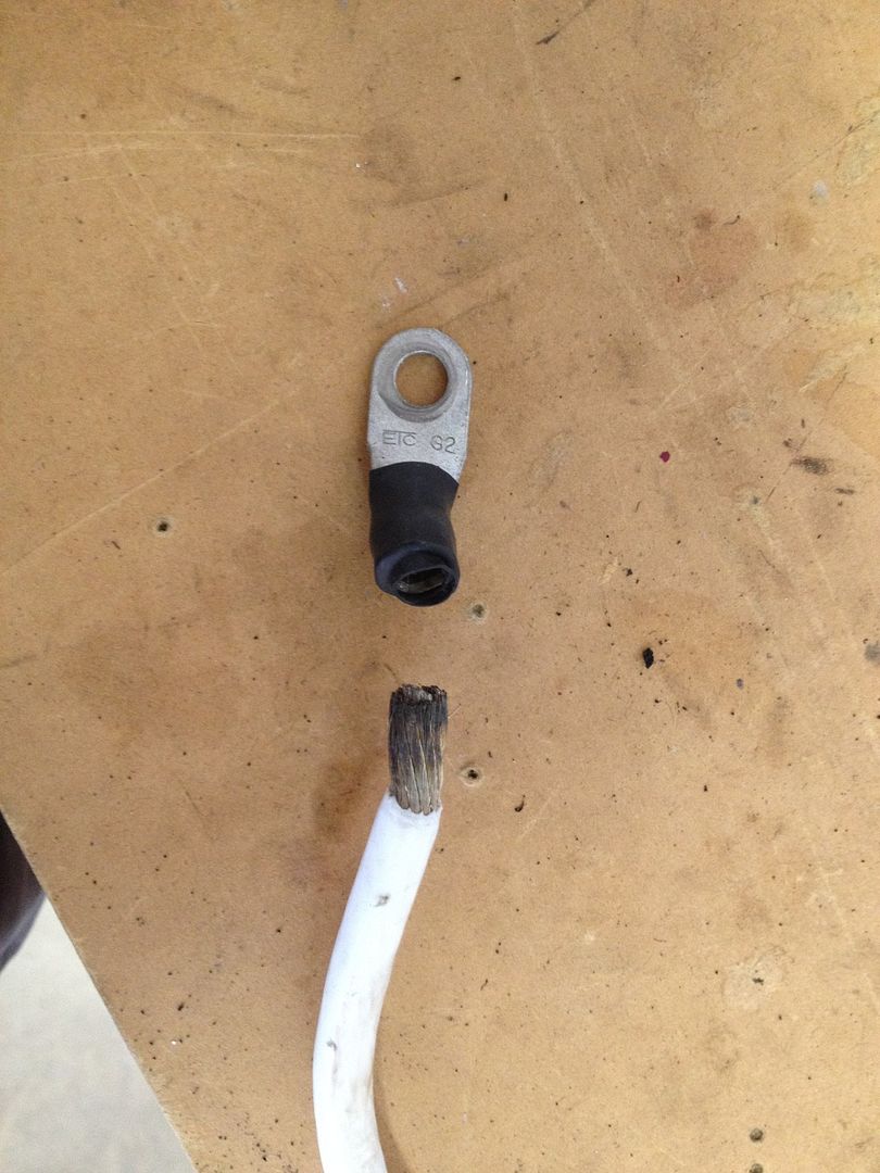

Low voltage
I've been having a low voltage problem lately. Sometimes while starting, the engine would barely turn over, other times it would work ok. While running the system voltage would be around 13.1~13.4 volts. I checked the troubleshooting page from Plane Power and went to the hangar ready for a diagnostics session. Getting started I decided to give all the big connections an inspection. The cable below connects the engine to the firewall. When I pulled on it the connection was snug, but it moved a little. Another tug and the wire came out. You can see the wire has been blackened due to the electricity trying to flow through it. Fortunately this wire is plenty long, so I was able to cut it back and crimp a new connector on. Problem solved!
RY is ~2 1/2 years old with 235 hours.
[/URL][/IMG]
Was this a Vans part or "home built"? Vans had some weak joints a few years back. The pull test on a #2 connector is about 550 pounds. That's right, 550. This should be kept in mind when checking in the plane- the pull force for a good joint is substantial.
I had the same problem with the engine to firewall ground cable from Van's. I cleaned and soldered mine and have had no further problems.
Vans supplied part. I don't have a device to measure the pull force, but the new one feels solid, Come to think of it, I can't pull on it that hard either!
