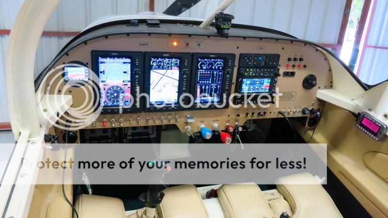

Well, I guess it's time for the before-and-after photos. Today I officially declared the panel done (well, it's never done, still have to install the GDL 39R in the morning). But the configuration and calibration are done and the engine has been run, magnetometer calibrated on the compass rose. Here's the before (started the project on June 23rd):
And this is the completed panel with the interior back in. Probably will fly on Saturday and I'll post a writeup on the new GMC 305 autopilot:
Here are a couple more:

Nice upgrade Pat! I'll call you when I get ready to upgrade mine in a few years!

Wow Pat!
What a nice panel. Be careful when you fly with this new panel, it's going to be hard to see whats going on outside, while looking @ that new panel!

I flew for an hour today and all I can say is, WOW!. Here are some quick observations...
Autopilot is very solid. Just like on the big planes. Altitude hold was perfect, no pitch oscillations at all. VNAV worked great; being able to program a crossing restriction is a great new feature. Didn't have time to do a coupled approach, maybe next flight. Auto trim worked as advertised. I gave it a good workout, I think I tried to break it but couldn't. I'm very impressed with this autopilot!
The traffic and weather returns were amazing! Great coverage here in Florida and the GDL39R was working perfectly.
Too much to absorb in one hour.
Next project is to get the fuel quantity calibration done and then the angle-of-attack calibration in flight.
All in all, I?m very pleased with the new panel! Ecstatic might be a better word.
