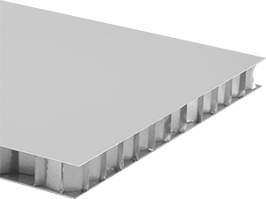

Old 08-15-2021, 06:20 PM
jliltd jliltd is offline
Join Date: Sep 2013
Location: Rancho San Lorenzo
Posts: 1,140
I bought a piece of honeycomb aluminum panel from McMaster-Carr. Super stiff and light.
https://www.mcmaster.com/catalog/127/3993
