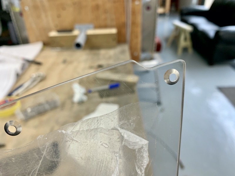

OK, doing a "Take Deux" of the rear window after a gut wrenching and
expensive crack. Don't ask......
Now, trying to figure out what distance should the aft window overhang the Roll-bar Shims - F-01431D, before I drill again. I don't have a plane to look at, and I am not sure how far the fwd canopy overlaps aft.
Right now I have it where the channel created by the shim is not covered, and it is even all along the bar.
Anyone want to send me a pix or tell me what works?
TIA!

I recommend you move it fwd. slightly so that it extends fwd, just beyond the edge of the aft ribs. This will give you a little more edge distance on the holes.
Then when you fit the fwd. canopy, shoot for a finished gap of about 1/16". This is to allow for the large amount of expansion that can occur in very hot temperatures.

So it is better to have the rear window hang slightly forward of the aft Rollbar F-01431 Shim?
Just want to be sure that leaves me wiggle room with mounting the forward canopy when it comes.
I understand and like the idea of some edge distance from the screws and definitely want the expansion room!

Yes, you want the rear window slightly ahead of the shim. Mine was roughly 1/32"+ forward of the shim when I started mating to the canopy.
If the rear window is exactly even with the shim, you're going to have a hard time getting the finished edge to look nice as you'll be completely reliant on the shim itself for your edge. I'm sure there's a number of different ways to do it, but to mate the forward canopy with the rear window, I used a piece of 120 grit sand paper stuck to a 1/64 piece of ply with 3M 77 and worked my way around the gap. This will mate the rear window to the canopy and they will fit perfectly.
Once that small gap is set, you can decide how large of a gap you want by varying the size (thickness) of the wood holding/stuck to the sandpaper and working your way around the gap again. Since the gap will be perfect, stick the sandpaper to only one side of the ply and take the material from the canopy. You'll put the side with no sandpaper against the rear window. Time consuming? Yes. Perfect...yes! I decided on a a .040 gap but may increase.
If the rear window is flush with the shim, you won't be able to take any material off of it to mate with the canopy and you'll be stick with whatever edge/fit you had when the rear window was installed.
Hope that makes sense.

Playing around with it now. At the lower parts of the Rollbar I get quite a bit of overlap when all the rest of the bar is even.
Is the Side skin supposed to be trimmed even at the ends?
I also noticed that the last hole on each side is about 1/3 way into the second side hole at the end of the Rollbar. (Pix) I'm thinking that it will need to also be shave to avoid any cracking.

Do you mean trimming the sides of the aft window (not side skin)? If so, then yes - the sides of my aft window were trimmed to be fairly even with the forward edge of the aluminum skin.
I did the final trimming after drilling all the holes in the aft window, since prior to drilling you won't know precisely how much to trim the forward edge of the aft window.

  • Yes, the rear window will need to be trimmed at the bottom. This is to clear the F-01474A stiffener angles. This isn't mentioned in the manual. FYI - I don't recall the window running down into the second hole, but that doesn't mean it didn't.
  • Regarding the front on the rear window (the edge that mates with the canopy), yes, if you let the window come past the shim it will extend a bit past the rear skin as it does in your picture. I think you'll find that the front edge of the rear window is relatively straight and when you mate the to the canopy with the procedure above it will come out very nicely.
One of the things that I found important was to put pressure on the front edge of the rear window to insure that it was contacting the skin in the rear portion. This will move that vertical edge in you picture back just a little. However it will still overhang the front shim slightly if done properly. It helps to have a third hand while drilling.
I can't take credit for the photo below, I borrowed it from Steve's web site, but I did the exact same thing.

Use a tapered reamer to drill the holes. I used #36 & #27s. Worked like a champ. I just finished mine and had no issues.
