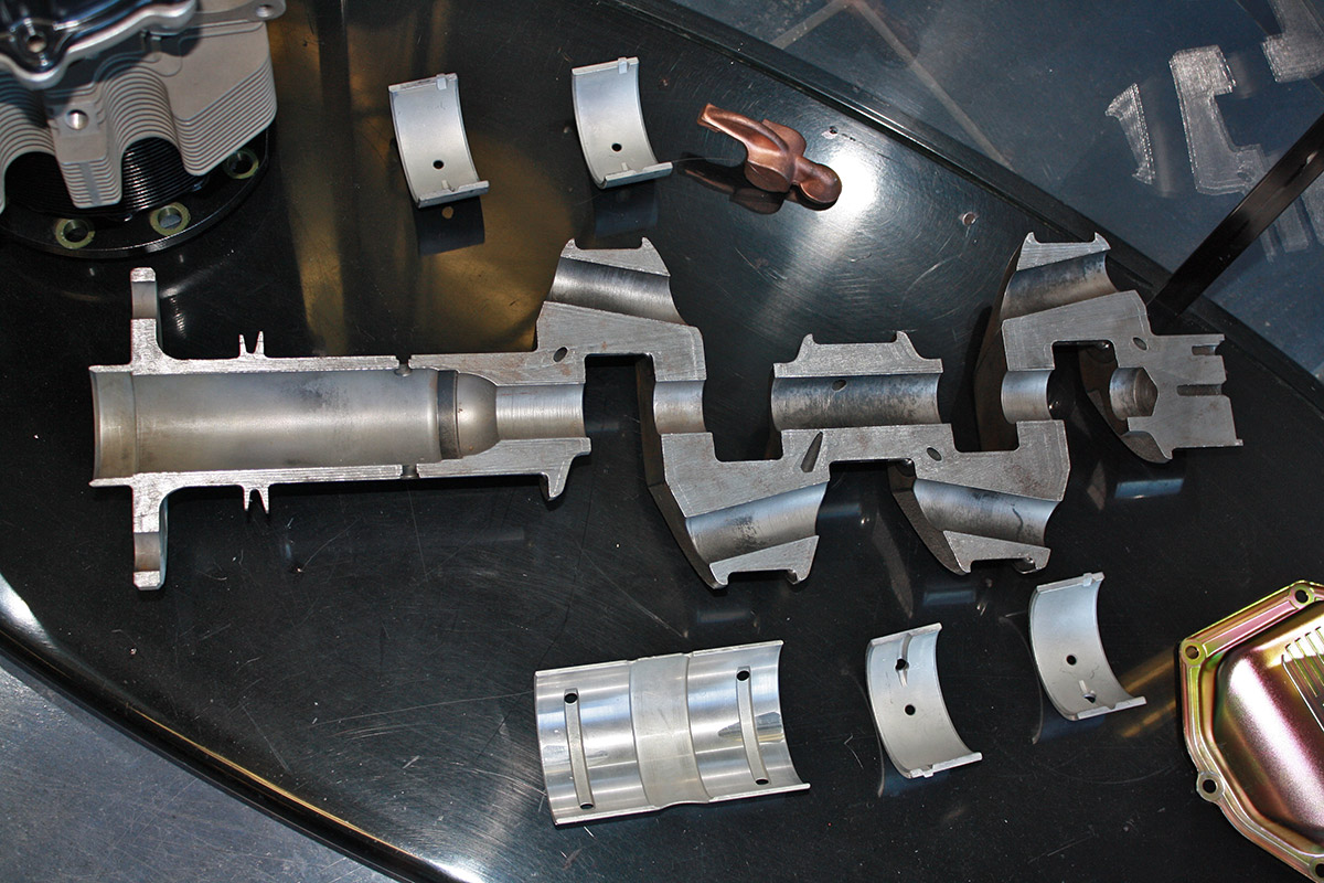

Just curious after looking at the cross sectional view of the crankshaft that is cut lengthwise in the article linked in a previous post.
Be curious to see how the 45 degree break in the number four journal mentioned in previous post aligns to the rod journal lightening bore shown in that cross sectioned crankshaft.
Haven?t built a lot of aircraft engines but have built many racing automotive, motorcycle and marine engines. Never seen a crankshaft rod journal done that way. Seems there are locations of less material area with the lightening bore done on an angle like that.
Only crankshaft holes done on an angle like that were for cross drilling oiling hole and they are typically about 3/16?-1/4? diameter.
Not an engine design engineer and didn?t stay at a Holiday Inn last night, just an observation.

Haven’t built a lot of aircraft engines but have built many racing automotive, motorcycle and marine engines. Never seen a crankshaft rod journal done that way. Seems there are locations of less material area with the lightening bore done on an angle like that.
Only crankshaft holes done on an angle like that were for cross drilling oiling hole and they are typically about 3/16”-1/4” diameter.
Not an engine design engineer and didn’t stay at a Holiday Inn last night, just an observation.
I agree. Very odd way of boring the lightening holes on the rod journals. Might make it lighter than a bore running straight through the journal but almost certainly weaker in a critical, high stress area. I've never seen any other crank machined like that. While it sounds like they did an FEA on the design, FEA is only a tool and doesn't prove much without actual validation by running the design at peak stress on the dyno for a long time.
FEA is only as good as the model and plugging valid numbers in to begin with. I've seen a number of broken parts now which proudly stating having had FEAs done. Backing your math analysis with actual running (lots) is the safer way to do things. You're not done after the FEA is complete.
Would be interesting to see photos of all the breaks. Yes, could be forging or heat treatment issue in the end on a small number of cranks but this doesn't look like a robust design IMHO.
I assume you are talking about this photo?
Forged in Germany, machined in the US. Rod journals are 2.125", same as 320, 360, 390, etc. Mains are 2.375" however, while a late model 390 is 2.625".
There is no pin overlap on the XP-400 crank from the photo. Pin overlap makes things much stiffer and stronger, especially on a design which doesn't have a pair of mains for every throw. Lycoming made a good choice by increasing the main size on the 390.

Listening . . . . I think he means overlap of the main diameter and rod pin diameter, but that is only for short stroke engines. The cheek thickness is primary for longer strokes.
The beach marks are very shallow on that pin and the progression of the brittle failure was odd. There is something else going on in this engine (design).
Looking at the second picture in the link from theduff.
Looks like crack started at that thinnest section area between journal surface and the angled lightening hole.
From the different colors of the crack surface the crack stayed in that starting area for a bit, darker color of the crack surface. Then cracked clean through shown by the lighter colored crack surface.
Wonder what the theory was behind the angled lightening holes.
Yes, Bill has it right. On the 390 with the larger mains, they may have a couple mm of pin overlap which makes it a bit stronger in bending.
I have seen failures like this one in race engines which were stroked with aftermarket cranks. No analysis, little proper long term testing. Despite being forged, heat treated, shot peened and having rolled fillets, one crank broke in less than 6 hours.
My theory was that these lacked proper damping and were ringing like a bell the whole time, ramping up the fatigue cycles rapidly. Seen similar breakages when folks removed the OE damper and went with a lightweight pulley instead. Fairly immediate failure again. The factory setups never broke cranks, even with hundreds of hours at or near redline.
