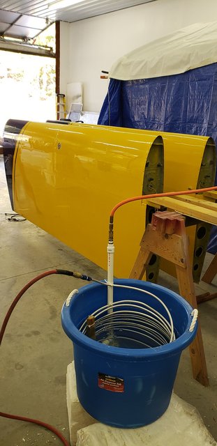

I’ve tried expensive guns and cheap Harbor Freight HVLP guns. I find the more expensive Harbor Freight guns give me the best result (but I run them at a higher pressure - so much for HVLP).

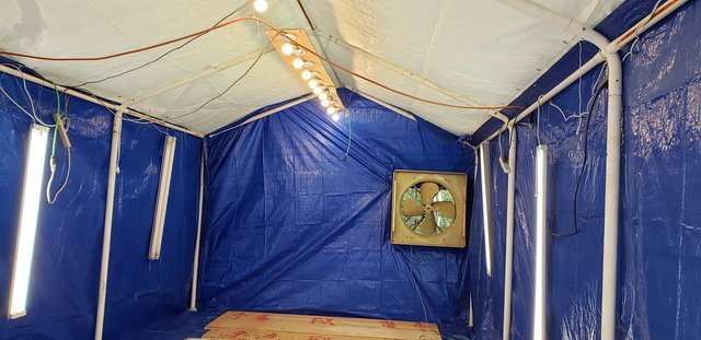

I built the paint booth and use an old attic fan for exhaust, inlet filter uses a panel of standard furnace filters.
Dry air is critical. I use this tub full of water and block ice. It has done the job very well. Just remember to drain it every hour or so.
Side note: If you have any decent air flow air conditioning will be sucked out in a few minutes.
Carl
Gun is your choice high dollar or cheap. You will be able to paint if you are able to paint. I have a bunch of them. Most expensive is just north of $800.00
The air dryer is mandatory,
A big bonus is if you are able to put a second tank to let air cool and reduce the compressor run times.
I have an 80 gallon compressor outside in a small enclosure, piped to a 120 gallon tank (Craigslist for $100.00) inside then piped to the Maxline system in my hangar.
I also have an air dryer on my painting air line.
No problems with water here,
Had those in the past, so I went overboard on the dry air system.
A couple of fish eyes from water in an otherwise perfect job really sucks. OH YA THEY ARE USUALLY ON TOP
Art

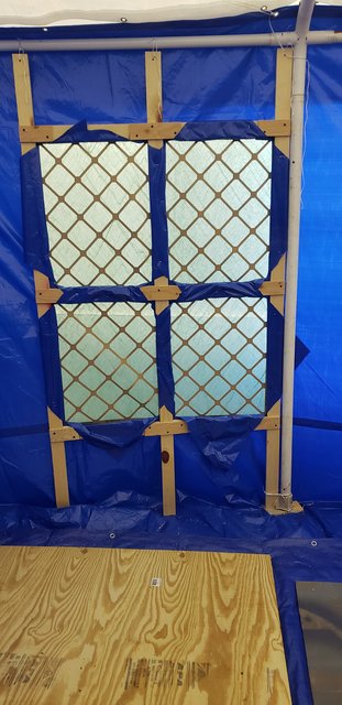

With your booth, one key is to make sure incoming air is filtered and is moving at low velocity coming into the booth. That'll keep the incoming air from carrying a lot of trash into your paint. Your exhaust system can have high velocity if that's necessary to move an appropriate amount of air. Exit air won't put dust into your project. Filter your exit air to capture most of the overspray before it lands on whatever is downwind from your booth.

Consider how you will exhaust the paint mist. I built an elaborate booth including an explosion-proof 220v exhaust fan. Turns out even though it was variable-speed it would only run at full speed. Very effective but it created so much suction it was a challenge to keep dust out of the air, as it was pulled in from the next county. Plenty of folks have used Walmart box fans but after a buddy set his fabric wing on fire from a static spark while spraying Aerothane I'm leery. It's the main reason I would use a water-based system next time.
Dust-wise, I had better luck with a previous project in a garage using a couple of small box fans that blew in through furnace filters, so the booth was at a positive pressure. None of that was isocyanates. You don't want those leaving the booth near your house except through an exhaust fan.

This is why you create a large inlet area/filter. That will keep the air velocity down on the intake side and bring in less dust.
The small parts booth at work has 5 24 inch by 24 inch intake filters and two exhaust filters of the same size. The single exhaust fan is in an 18 inch diameter tube.
