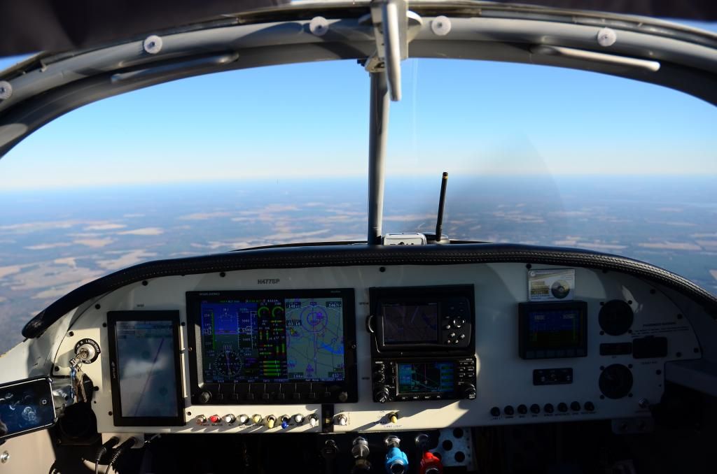

I’ve included a pic of my panel below to go with my explanation. Skyview is primary with backup battery – 30-45 minutes, backup is the D6 (right side) with backup battery – 30-45 minutes. If they all buy the farm, my backups to my back up include – the Garmin 496. Obviously this is all GPS based, but the instrument page contains a compass and turn coordinator type instrument – more than sufficient for me to keep the greasy side down. Also, the 496’s battery lasts a very long time if disconnected from ship’s power. Also, you will see a box/antenna on top of the glare shield. This is the iLevel SW which is primarily used for ADSB in, but also has AHRS (the battery for this lasts hours, but I can plug it into the 12-volt receptacle on the far right if need be). Via Bluetooth, this provides attitude data to my iFly 720 (left side of Skyview) and to Wing X on my iPhone (left side, in front of the eyeball vent). I do not routinely fly with my iPhone on, but keep it mounted in the plane to have it handy. I also carry my iPad with Wing X, but almost never use it in flight (only for preflight or enroute planning at FBOs).
