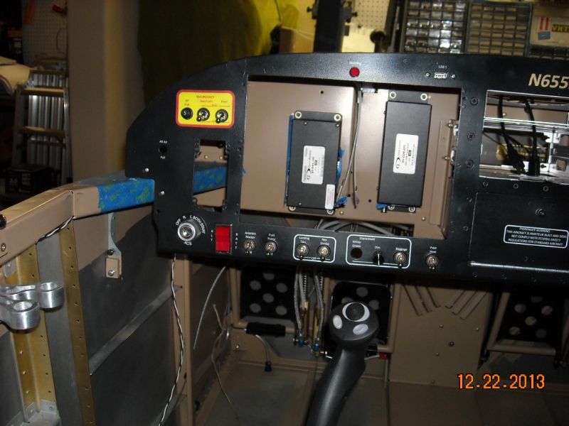

Here's my simple essential buss for an alternator/VPX failure:
Skyview PFD and MFD - each have a backup battery so no additional setup needed
GTN 650 - Com1 and Nav has a dual pole switch to connect direct to battery
Pitot Heat - switch to connect direct to battery
Logic:
Com1 can talk to anyone, bypasses audio panel
Nav to find nearest airport and fly an approach if necessary
Pitot heat if in clouds
Skyview backup battery good for 1 hour
All lights will be off to conserve battery power
No transponder - will be talking to ATC anyway or if VPX is working, I can power it on manually
fuel pump - uses a lot of power and a risk I was willing to take
This picture shows my emergency section of the panel with the autopilot breaker, Nav/Com and Pitot switches
