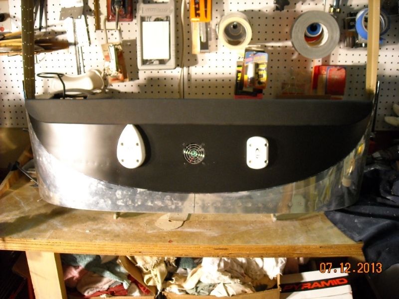

Mine is a used 3" fan from our first computer. If it fails we have another from our second computer. Didn't even think about buying one new...
No idea of cfm but with only avionics as a heat source it clears the windscreen very quickly. I can just feel the moving air as it hits my face.
It doesn't take much if you put it on as soon as you get in. The aircraft is an -8 so a side by side would probably take two fans to clear the entire windscreen...
I did paint the "grill" flat black so it wouldn't reflect in the windscreen...

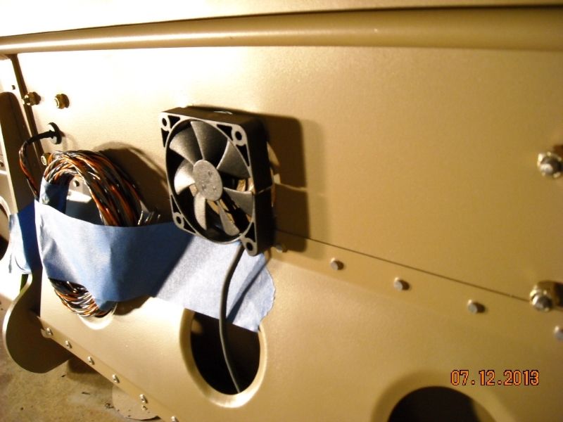

I'm curious... how are some of you guys with tip-up canopies mounting your fans? I bought a pair of 3" computer fans to mount underneath the glare shield, but I'm running into problems. They will run into the top flange on the panel when the canopy is lowered. They can only be mounted so far forward under the glare shield before running into the canopy braces.
Does anyone have some ideas to share? Better yet... any pictures? It looks like I'll either have to get much smaller fans, or mount them on top of the glare shield (I really don't want to do that, if I can help it).

I found the same issue on my tipper. I purchased squirrel cage blower style and plan to use some scat hose with slots. The plan is to pull from the heater box. It is not installed, so that could change.
I have seen the smaller fans installed neatly in the glare shield, don't know the size, or have a reference, sorry. I have extra axials

A 3 inch fan is probably too big. Here's a pic of my 60mm fan. It overlaps the brace a bit, but it doesn't need to be perfect to move the air. It has to be back far enough so it doesn't hit the panel when the canopy is closed.
Note that I cracked the housing when I tightened the screws, but it still works fine. I already have a new one to replace it when it fails. They only cost $5 on ebay.
