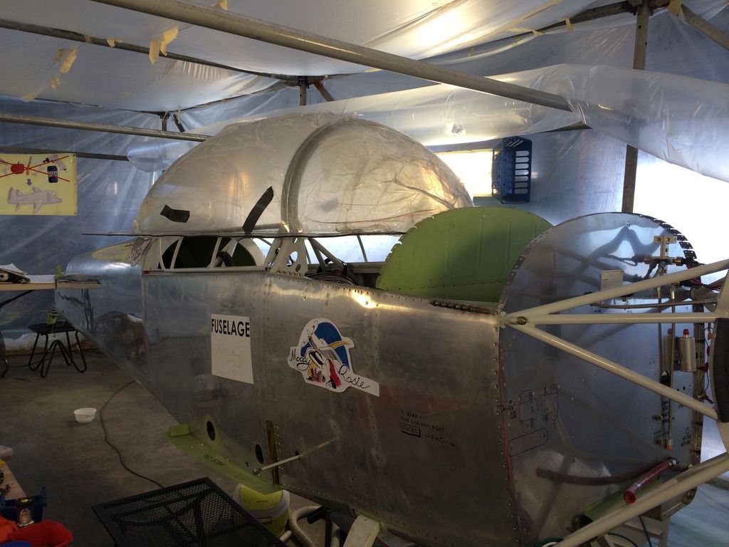

It must be a busy year when it felt like yesterday when I posted my last update on the project. It was indeed an extremely busy year to get the aircraft ready to fly. I am extremely fortunate to have a fellow pilot from my airline to join the building effort. Geoff from Australia built 2 RVs before, with his knowledge, he saved the project both time and money from potential traps and hurdles. On a sad note, Michael Tam, a friend who helped the project since the beginning, past away in a car accident. He was the electrical guru and extremely skilled pilot, the electrical system was his "baby" and it was completed the night before his departure.
One positive aspect of moving from the school to the maintenance hanger, is that the project attracted a lot of interest from local engineers and mechanics. The project was at the stage where their skill and knowledge comes into play, and I can't ask for a better sets of hands to help out.
The aircraft is now almost completed and ready for her first engine run. Our next hurdle is how to bring the aircraft back down to the ground from our roof top workshop....

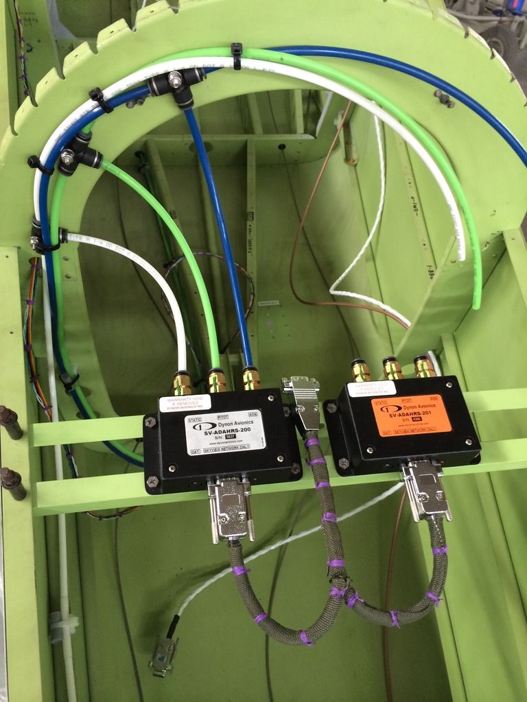

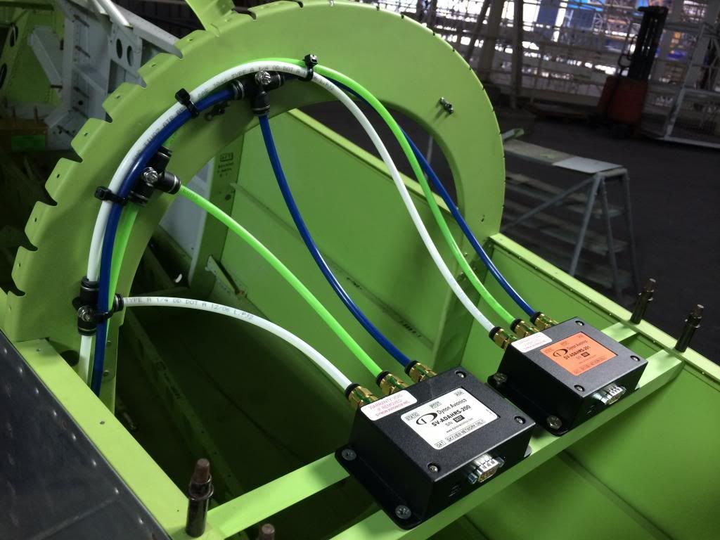

Building the ADAHRS Rack
ADAHRS wiring and lines routing

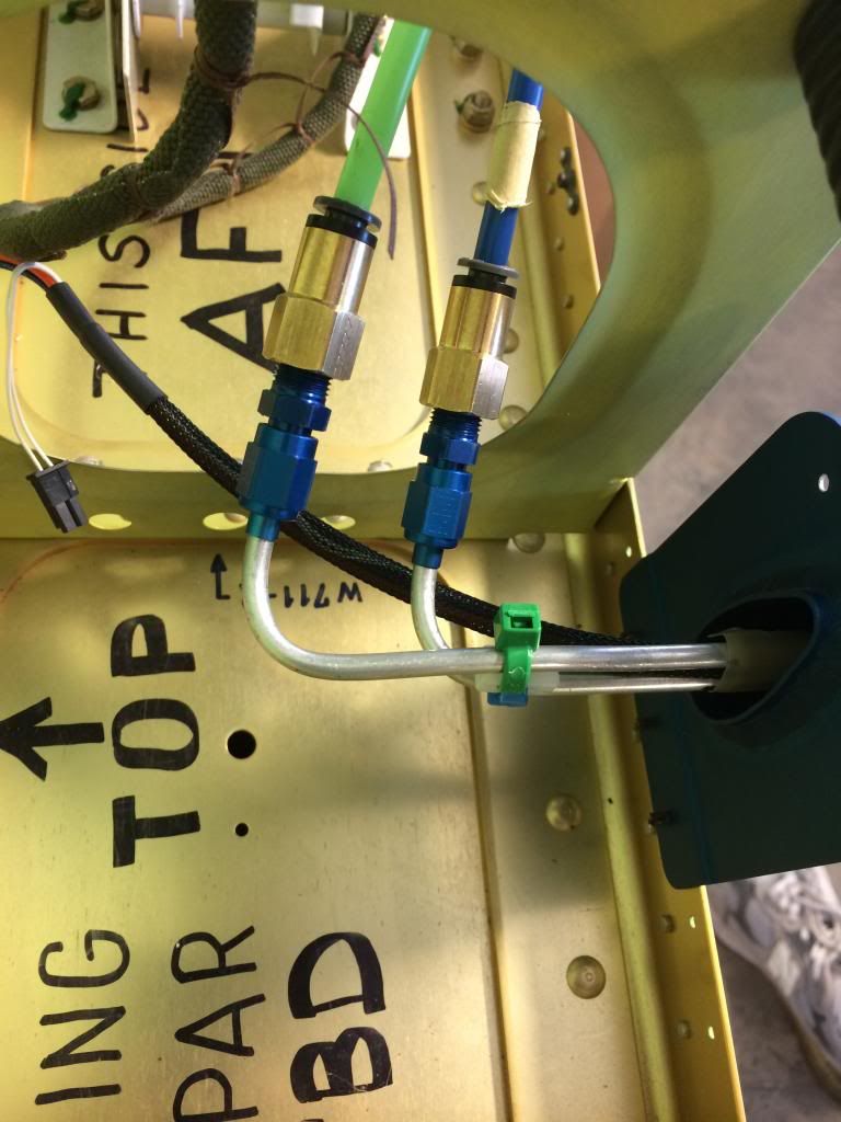

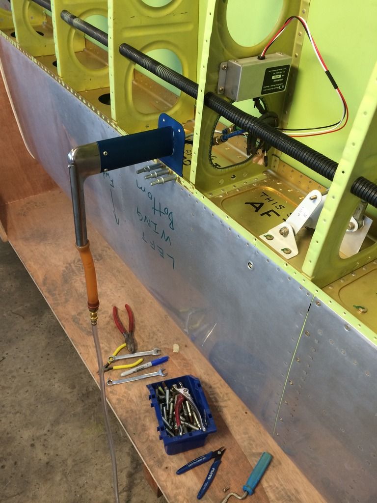

Pitot/AOA Probe Plumbing

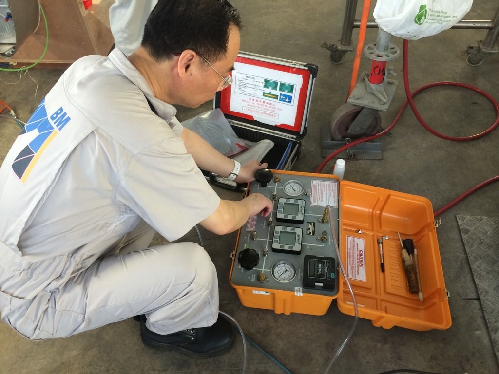

Probe testing
using a tester from the maintenance facility that I can't afford otherwise

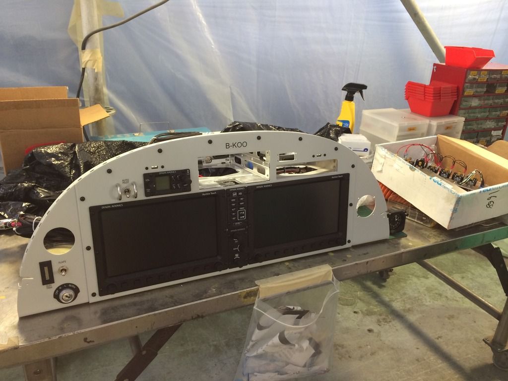

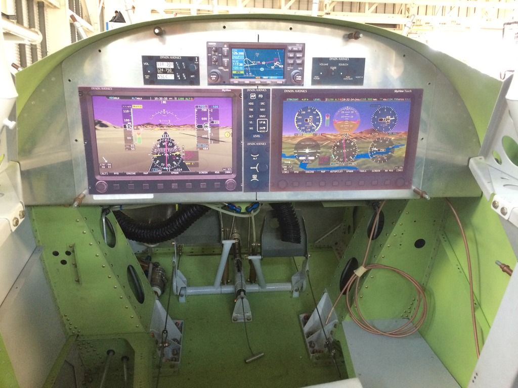

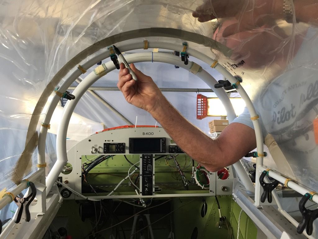

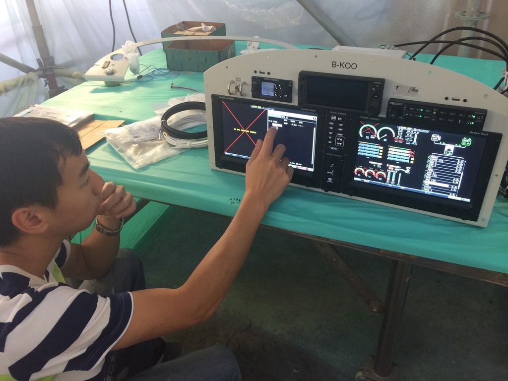

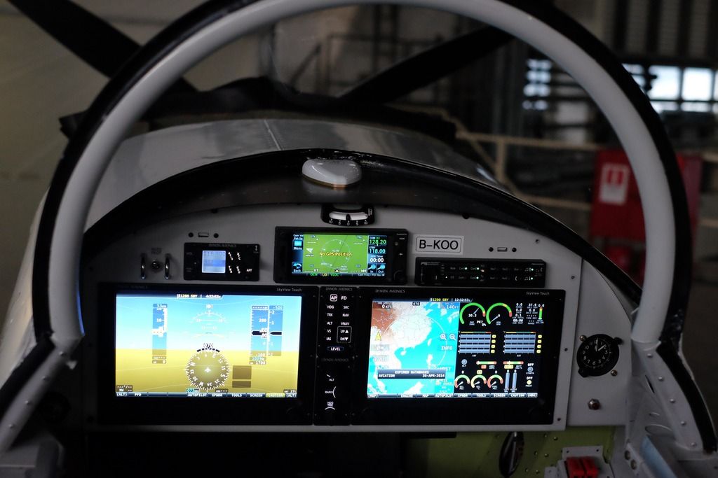

Panel Planning
Panel for real!
Michael powering up the panel for the first time, it works!

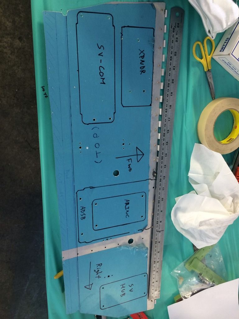

Building the avionic rack

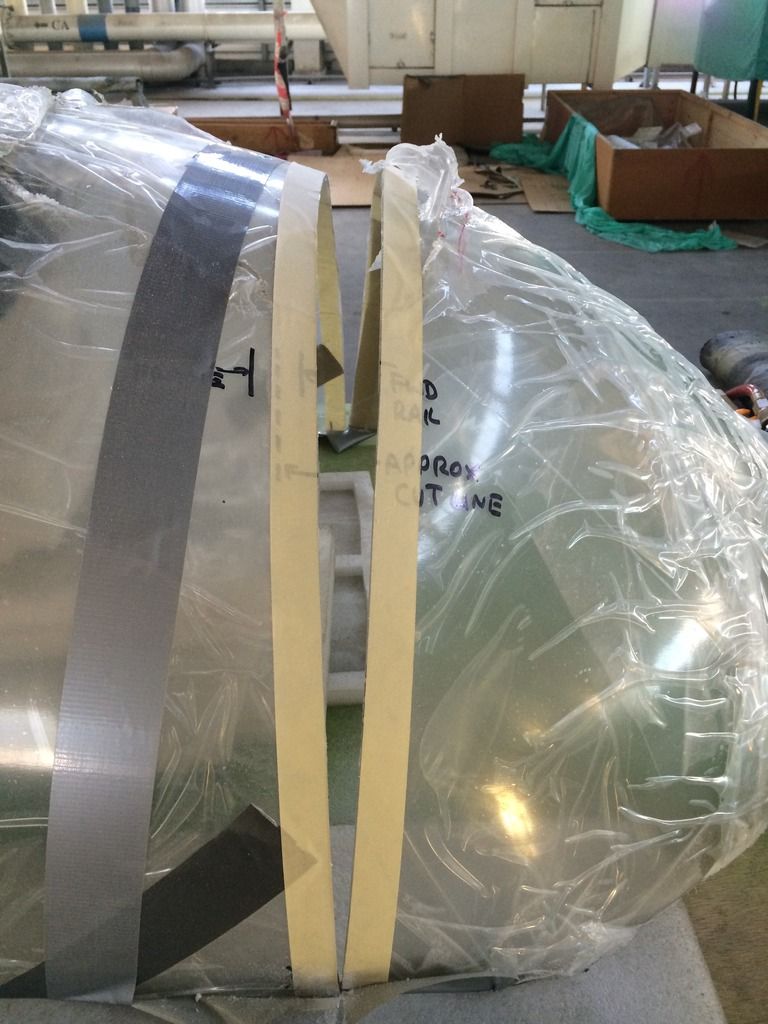

Canopy cutting. We waited for the summer of Hong Kong where temperature does not go below 90F.

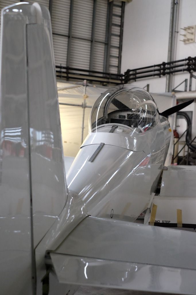

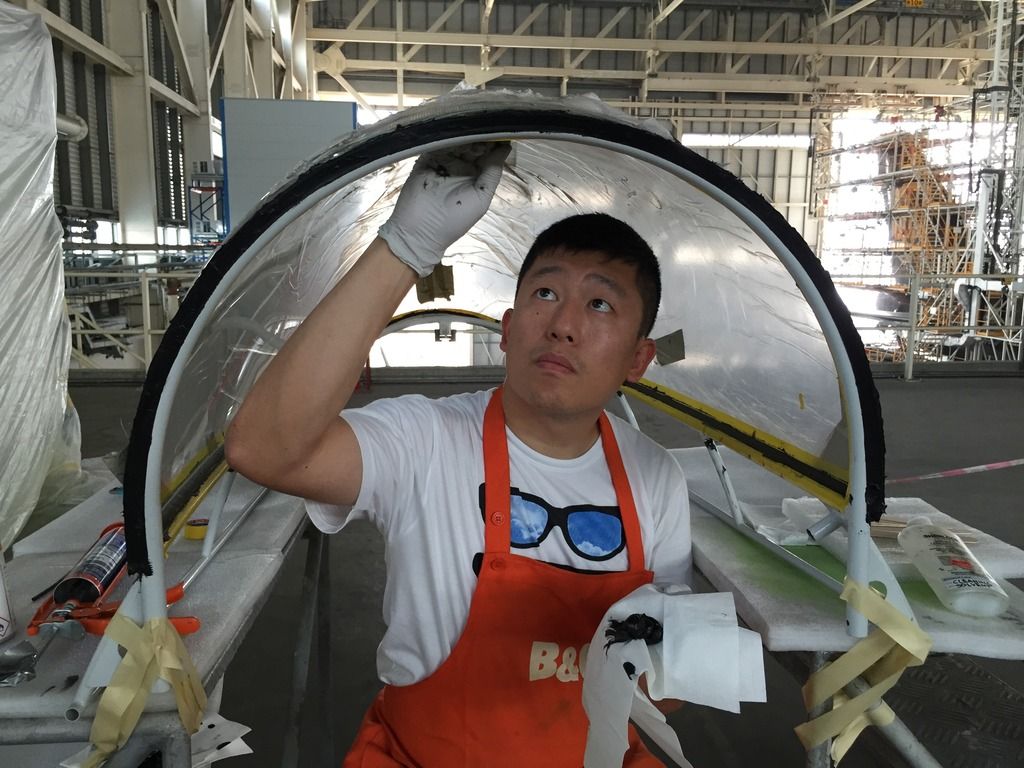

It was easier than I thought but can't let the guard down
Clean cut
We went the Sikaflex route and am happy with the result
I am surprise they sell them here in Hong Kong, and cheap! less than $10USD a tube!

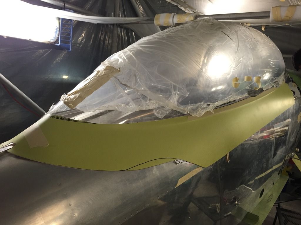

Canopy Skirt went on okay, on and off countless time for trimming

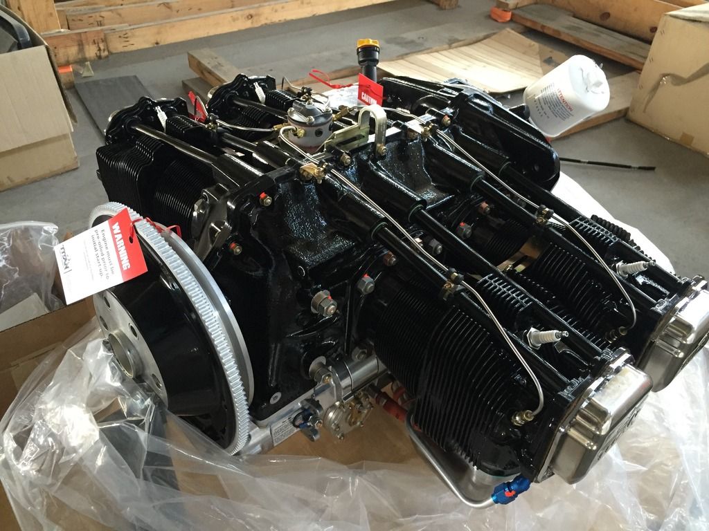

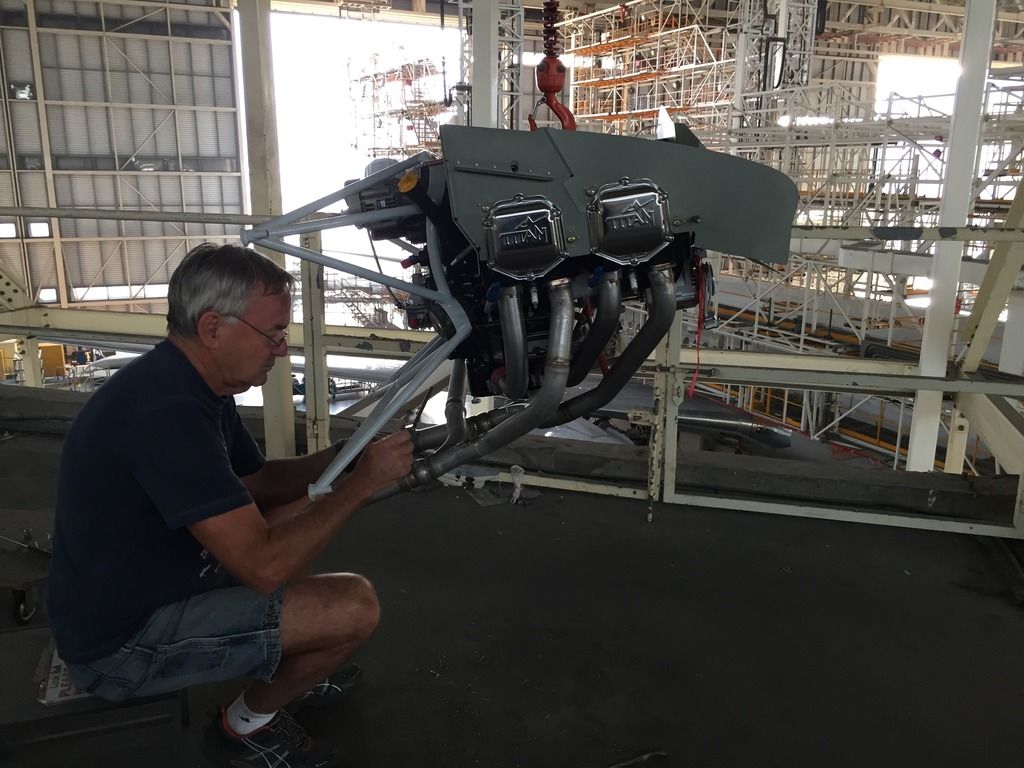

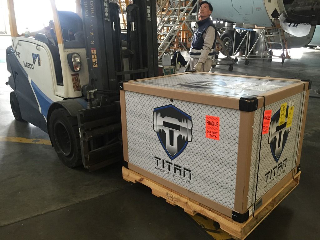

Engine arrived!
Looks new!
Geoff in his element

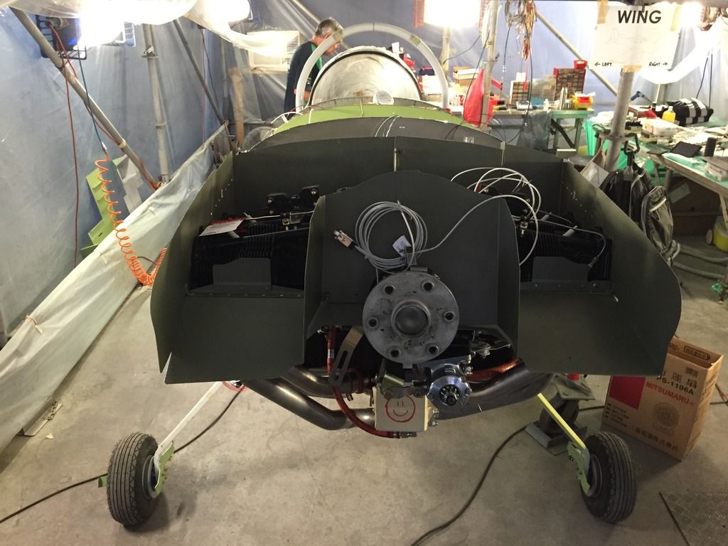

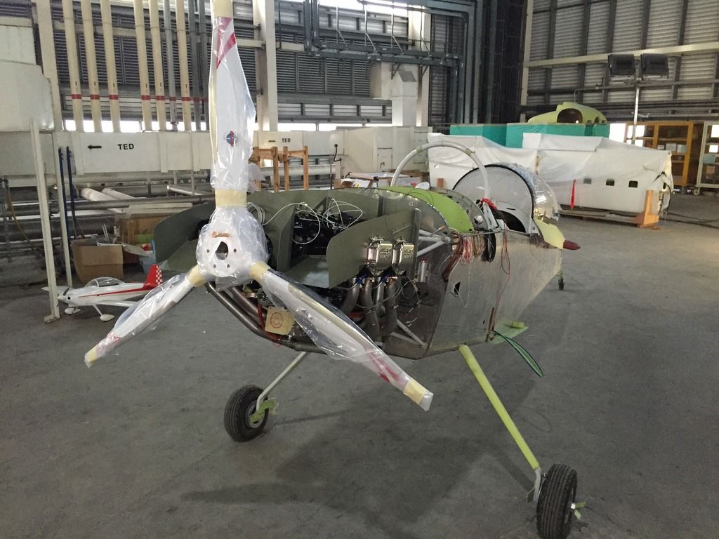

Baffling was probably the most annoying part of the build, Titan didn't make it easy with the tapered cooling fin, we modified the Van's baffle kit so that it will contour the fins to allow max cooling.
Begin to look like an airplane

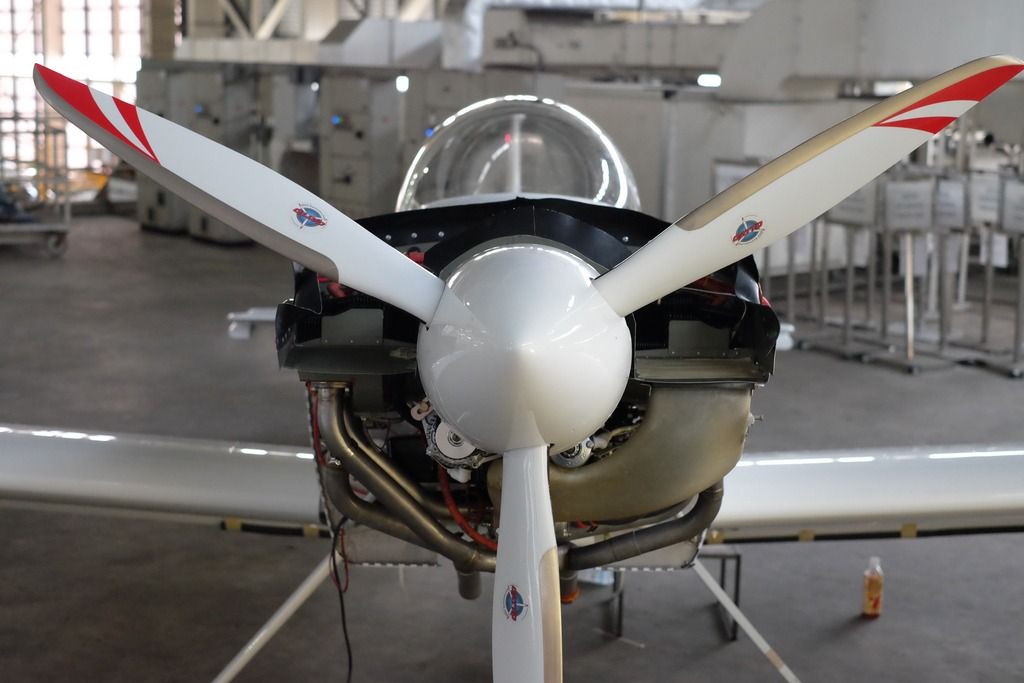

A brand new Catto RV8 Prop, sponsored by Catto prop! Took delivery when I operated to SFO and visited Craig's workshop. Many many thanks to Catto Prop for their generosity and support!
Problem.....
Problem solved
Arrived safely!
Love the three blades prop!

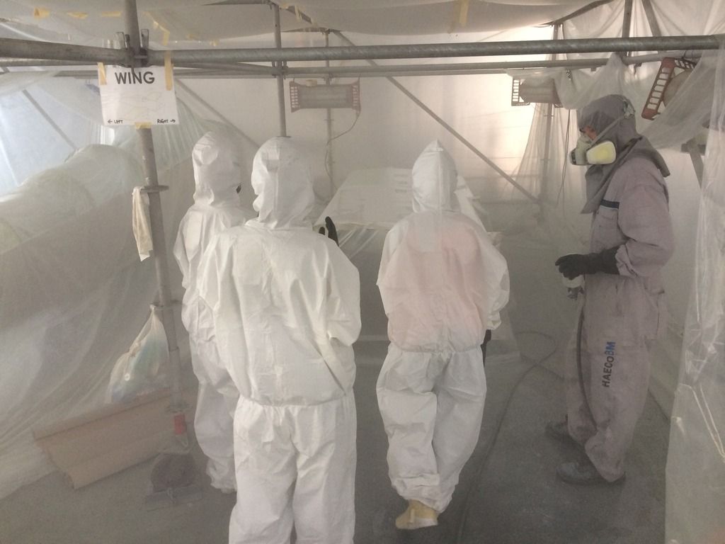

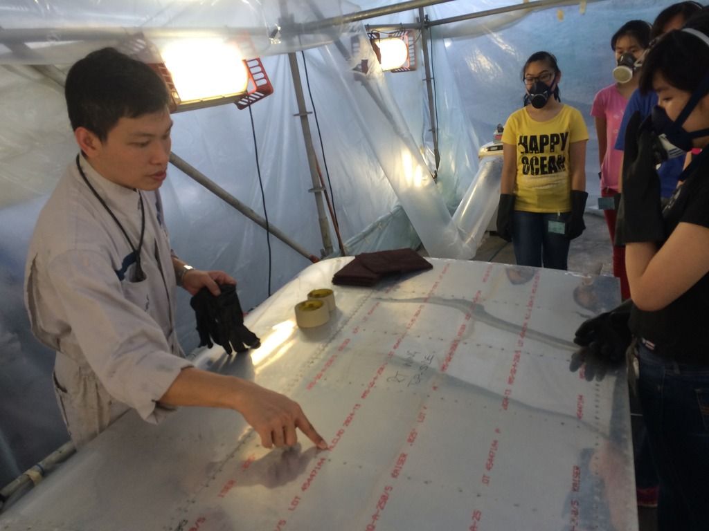

Painting day! Engineers gave instruction to the student on the basics of painting and safety equipment
Try on smaller parts before going big

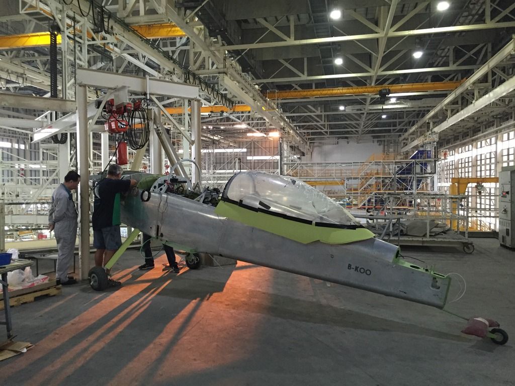

First homebuilt registration in Hong Kong: B-KOO
Almost there!
