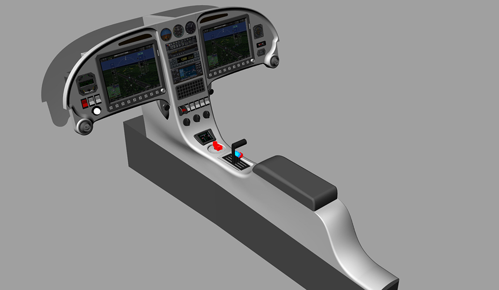

Originally Posted by Lenny Iszak View Post
How about here
OK, Lenny-------details please.
Is this only some computer generated pipe dream, or is this going to actually exist?
Haha, it used to be that, but it's been real for a while now. Nothing remotely close to the beauty and precision of Geoff's stuff though. Designed in Rhino, cut out of foam on my homebuilt CNC, then glassed over. Just a one off, no molds.
Efis screens existed but have been replaced with AF-5800's. That WAS a pipe dream
Will take a picture of the real thing sometime.
Lenny's plane looks just as fantastic as the model!

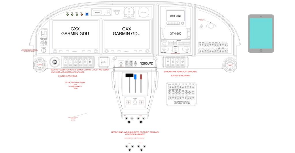

Just when I thought I was really happy with my design....
JK... But seriously, the new panel design looks Siiiiick.... Just means another $4k for the screen.....
Oh well, It's on the bench at Stein as we speak....
IPad is going on the far right. Low profile, quick release to get to the breakers if/when needed.

John - very similar to my thoughts, I've just got enough time to incorporate the new center console. My only question - do you roll down the windows to get to it??

Thanks Ed!
Btw, I like the 3 screen design a lot. I actually never use the right side screen much. I set it for a big picture sectional so I have it there, but it's a bit out of the way, especially that I have short legs and sit closer to the screens than a tall dude would. Forget twisting the right side knob on that screen too. I'd have to be loosening up the seat belts for that. Thankfully they are monstrous 12" screens so a single one will still show almost everything i need.
With the 3 screens you have 2 for yourself that you can really use.
One thing I regret is putting my autopilot way out there on the left. I always have to reach over with my right arm or switch hands on the stick. I'd put that right smack in the middle if I had a choice.
For an iPad I just went with the iPad micro, aka iPhone 6 Plus, mostly because I want to have looping NexRad from XM, and Satellite view, none of which are shown by the AFS units.
I think what we really need is something like this:
