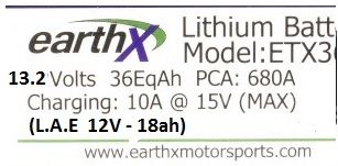

We would like to ask all of your for your input about the specs for a lithium iron phosphate battery. It can replace a lead acid battery, but it is not the same. To date, we have tried to write up the spec's in a comparison type language but maybe it's time to revolutionize this area.
A lead acid battery open circuit voltage (OCV) is technically 12.6V. (definition of an OCV is: Open circuit voltage (or potential) is voltage which is not connected to any load in a circuit) but we call it a 12V.
A lithium iron phosphate battery OCV is technically a 13.2V but the industry calls it a 12V so that people know they can use it as a replacement.
We are considering changing how the industry labels the batteries, or at least our batteries, and want to call the voltage 13.2V but we are afraid consumers will think they can not use it as a replacement for a 12v battery. Any thoughts?
Second question, any input on how to label the amp hours? This is an area that is all over the charts from battery manufacturer to battery manufacturer. (and marketing material as well) We want to state exactly how much amperage you have in the event you are using the battery as a deep cycle application such as when your alternator fails. We list both now, what type of equivalent amperage a lead acid battery would have for the amount of cranking power and the usable amp hour. We want to go to listing only the usable amperage but the numbers of what a lead acid might say will look much more in comparison even though it might be less as very few will list the true usable amperage. As an example, if we list the ETX680 as 12.4ah, and the PC680 list theirs as 16, but only have 12.3 usable for an hour) it is confusing. And if you compared another lead acid manufacturer, their listed 18 amp hour might only be 10 usable by design.
Look forward to hearing your input and thank you in advance!

Default L.A.E or L.A.Q?
How about labeling the batteries and your marketing material with a "Lead Acid Equivalent" marking something like (L.A.E 12v - 18ah) or L.A.Q might be catchier.

First, thank you for your continued efforts to provide 'apples to apples' comparisons; that's what we really need.
But...Statements like the one in your post, that a PC680 is rated at 18AH but only has 12AH usable, makes it look like y'all don't understand battery tech, at least lead-acid battery tech (though most batteries exhibit discharge curves that are similar in nature).
Lead-acid batteries typically have an ampere-hour rating that is based on a "20 hour rate". This means: how many amps the battery can supply, if the discharge is accomplished at a steady rate over a 20 hour window. Any shorter discharge window (higher discharge rate) will *always* result in a lower total AH availability from the battery. In other words, if you can get 20 AH by drawing 1 amp continuously for 20 hours, you will never be able to get 20 AH if you draw at a 20 Amp rate (you'll do good to get 45 minutes at that rate).
Here's a link to the actual specs of a PC680
http://www.odysseybatteries.com/batt...680_series.htm
And here's a link to a pdf of Odessey's performance data sheets (I think I've posted it before).
http://www.odysseybattery.com/docume...M-002_1214.pdf
Page 6 shows the discharge curve for a PC680. Note from the 1st link that the AH rating of a PC680 is 16AH; not 18AH. Looking at page 6 in the 2nd link, a 0.8 Amp continuous discharge can continue for 20 hours. 20*0.8=16AH. But if you discharge at a continuous 143 Amps, you can only do it for 2 minutes. 2/60*143=4.76AH. Your 12.8 AH usable figure apparently comes (approximately) from the line that shows a 12.3 Amp draw will last for 1 hour.
The chart and the graph give the same info, in different formats
So, if you want to provide comparable data, pick one of your battery models (the 12 AH model?). Determine the discharge rate in amps that will take your battery to the point where it (or its controller) will no longer supply usable power to the load at the end of a 20 hour window. (Odessey specifies 10.02 Volts as fully discharged.) That amp number, times 20, becomes the AH rating of the battery. Then do the same test to determine the current available over a 10 hour window. Etc, etc down (up?) to a 2 minute window. Write up a chart of the numbers, graph it, and publish it. Done.
I see no technical advantage to labeling your battery as 13.x vs 12 volts; but you might sell an extra battery or two to someone who doesn't understand the technical details, if that's a goal you'd want to embrace (I hope it isn't).

Maybe list it as 13.2V and put (12V replacement) somewhere?

THIS! Anything else is nice for "techno-geeks" but only makes things more confusing for the vast majority of your target market.
My 2 cents.

A lot of lithium battery makers already use that term, and that's what's wrong with their marketing. They use it to describe the battery's ability to crank an engine, which has almost nothing to do with the total *energy* in the battery. Cranking takes 3-5% of a lead acid battery's energy content. With some lithiums, it might consume 20-30%, meaning that the total energy in the lithium is much lower than the lead acid 'equivalent'.
Think Corvette with one gallon of gas vs a Civic with a full tank. The Corvette will be ahead the 1st couple of miles, but the Civic will win the race by several hundred, and move a lot more weight in the process.
