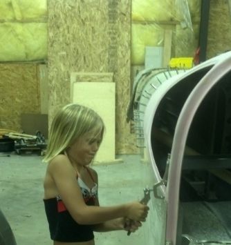

Jack--priceless expression on you daughter's face in that second pic!
