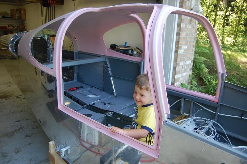

I did the slow build and would do it that way again, but I really enjoy smashing rivets and seeing the structure come together. I just checked my log, I spent ten months on the fuselage kit, out of a 6-1/2 year build. So, for me, going quick build would not have saved a significant amount of time. But, I worked hard on that kit, and took breaks at other points in the build.
[IMG][/IMG]
