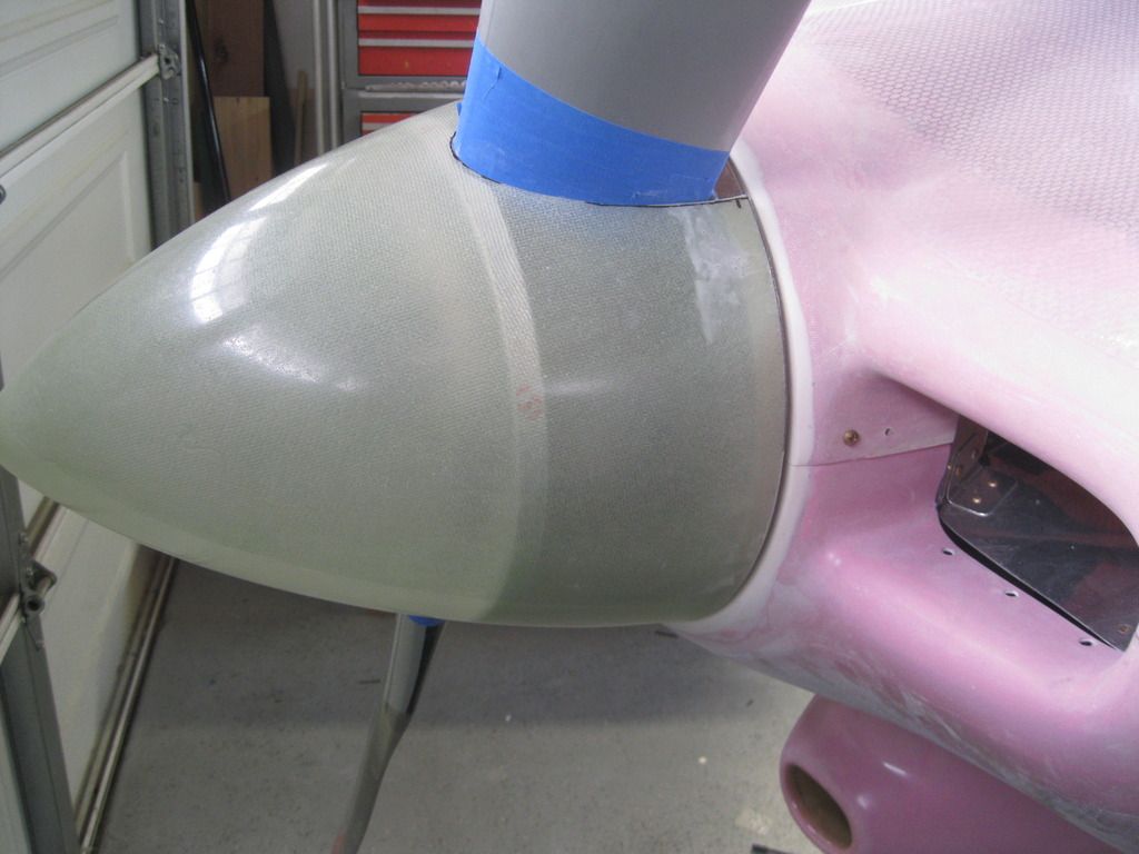

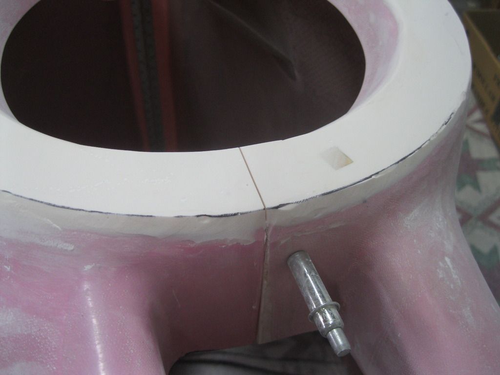

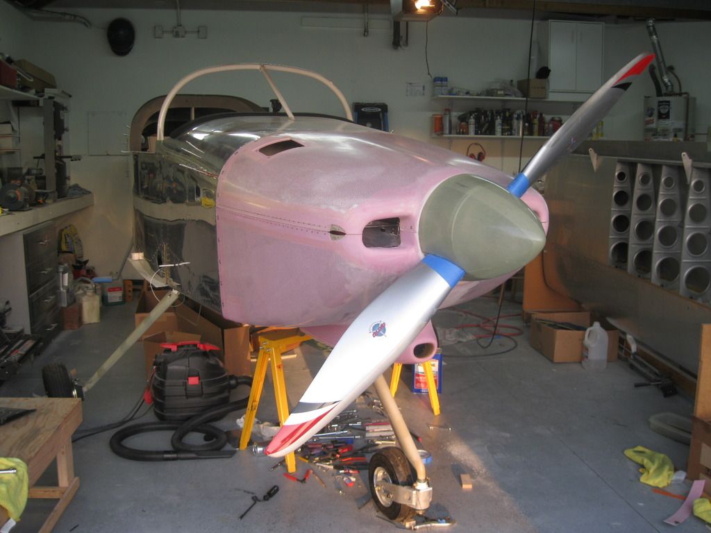

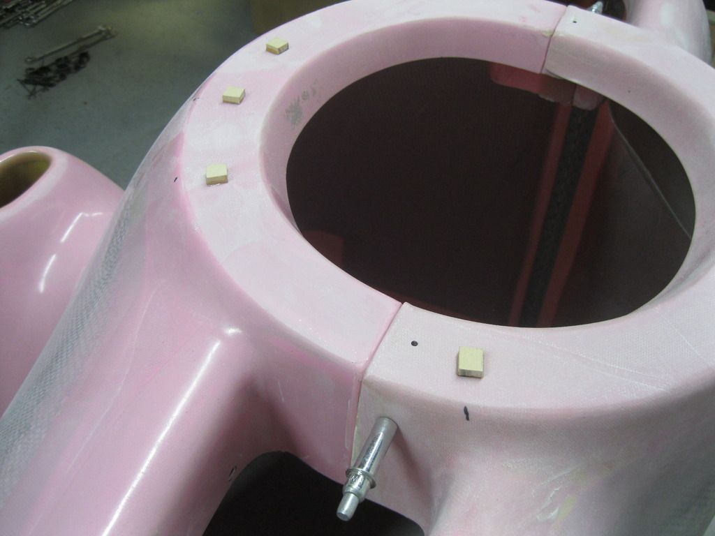

It felt great to bolt up the Catto 70/70 for the first time and fit the spinner. A huge relief that the forward bulkhead fits nice and snug on the spinner, with maybe 1/16" of fiberglass overhanging the rear bulkhead, so no spacer required.

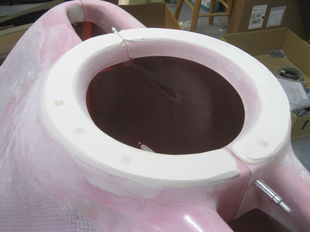

I went the extra mile and built up the cowling where it meets the spinner with dry micro...a ton of work, but there was just too much of a gap for the level of finish I'm aiming for. The rear bulkhead had a minimum of 1/4" clearance (11 o'clock, facing the front of the plane) and a maximum of 1/2" (5 o'clock). Since I wanted a nice, even 1/4" clearance all around, I glued some little chunks of 1/4" bass wood near the 5 o'clock position, which will be encapsulated in the dry micro when finished.
Got some glass (a panel from the coffee table was ideal), mixed up a bunch of "frosting" and smooshed the waxed glass down over it. Darn, not enough micro....do a second application, sand, sand, sand. The third application was for the cowling seam, where I used some waxed aluminum sheet to make a nice crisp parting line. The garage looks like a flour mill and I'll probably die of "microsphere lung," but it turned out good!

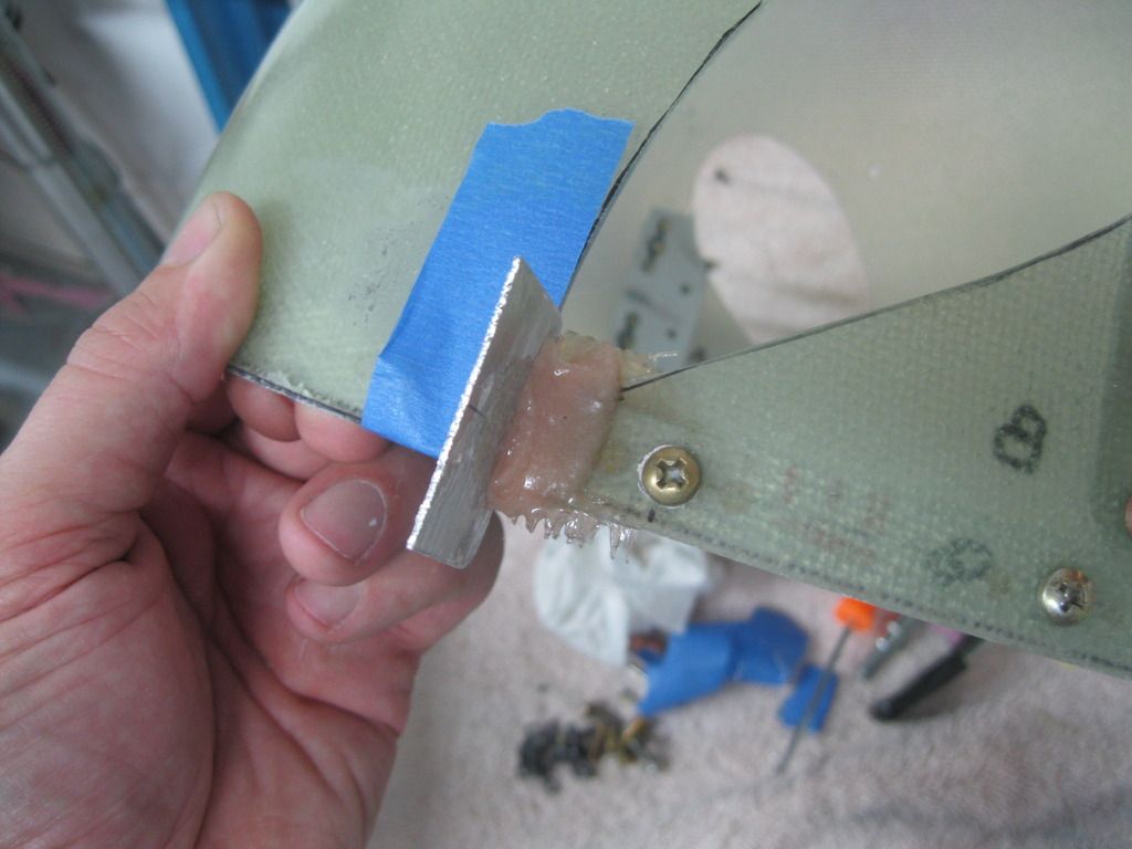

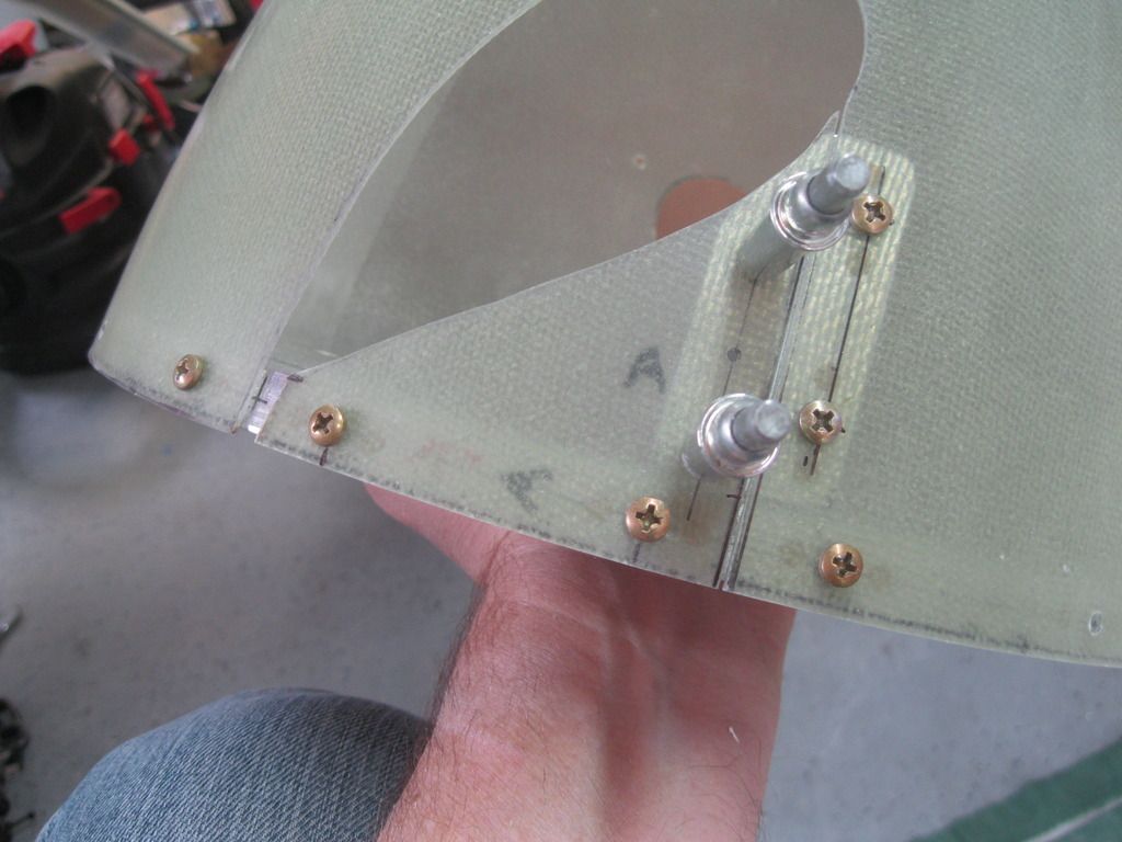

Made the filler widget pieces for the spinner. I ended up using 0.040 aluminum for the backing plates because it's easier to bend to the spinner's curvature. It's a light piece, and with two hefty screws it's not going anywhere. All the shaping made the end come up short on the rear bulkhead (just 3/8" or so, but it looks terrible), so I extended it using the bulkhead as a mold. Underneath is a scarf joint with three layers of 9 oz, then a blob o' flox on top.

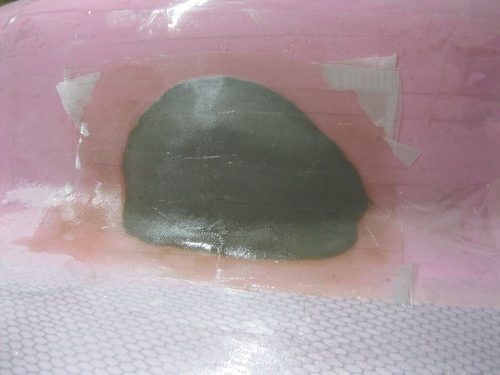

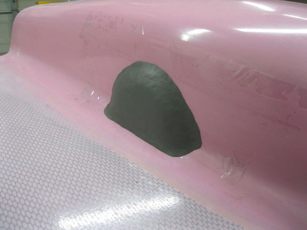

Next up, the "speed blister" () on the lower cowling for mixture arm clearance. I found some cheap plasticine clay at Michael's (Craftsmart brand, $2.99 a pound), sliced the brick in half to make a nice slab, applied it to the taped-up cowling and molded it with my fingers. It's a little larger than it needs to be, but I wanted to make sure there's never any contact on startup/shutdown.
Then a coat of paste wax, which of course is mold release, but it also lets you smooth the clay more easily into the final shape. More eyeballing, tweaking, and application of a second coat of wax. For the initial layup, I used two layers of some extremely light cloth that I dug out of my rc plane stash, in the hopes the exterior will need less final sanding & filling. I plan to reinforce it later from the inside with 9 oz. cloth.

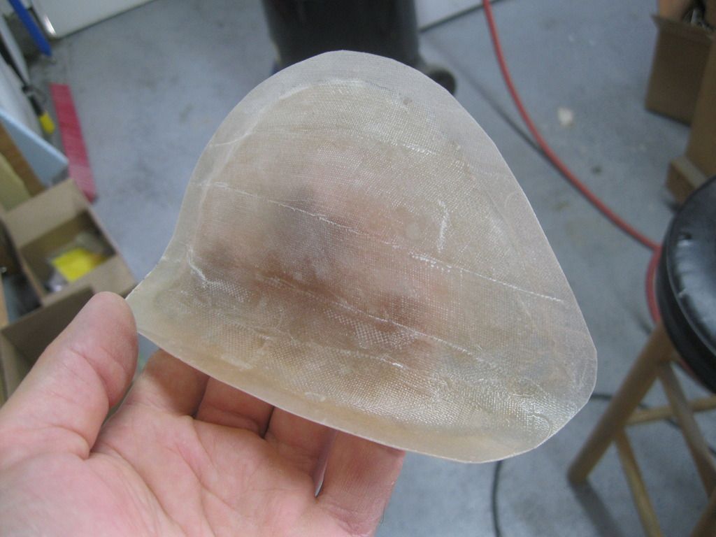

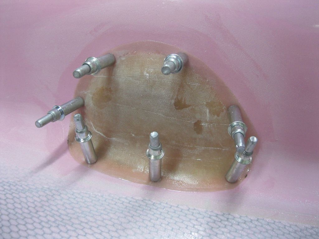

Here's the blister after trimming. It came off the clay pretty cleanly. I wiped down the inside with acetone, scuffed it, applied some 9 oz. cloth, then floxed it to the cowling with the aid of some clecos. From the inside of the cowling, I smeared a generous fillet of flox around the perimeter of the mating surface, so it's super solid.
The filler piece for the spinner turned out good...a lot of work to add this small extension.

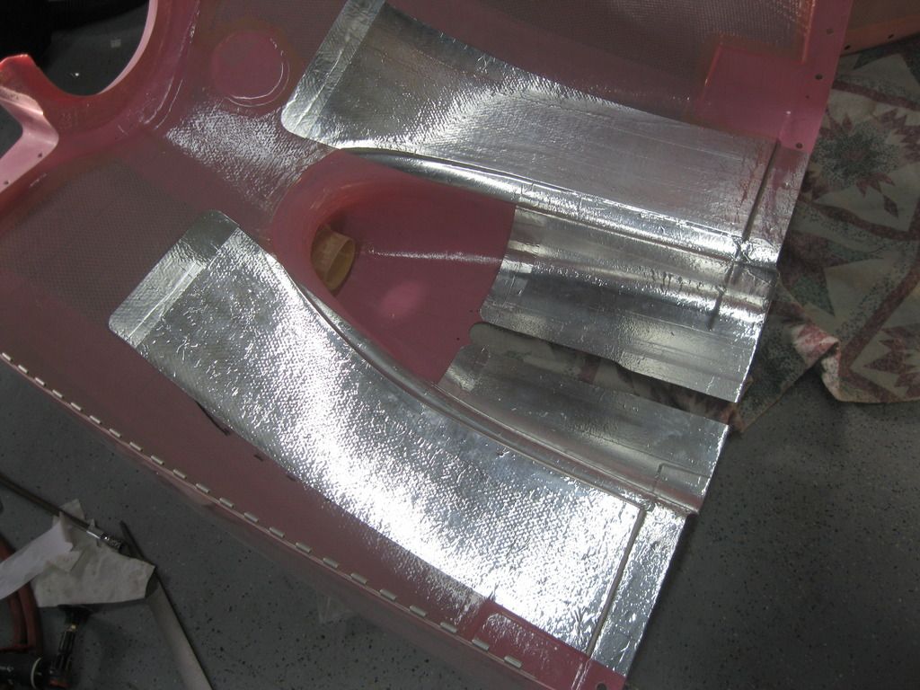

More work on the cowling. I sanded and epoxied the inner surface, then applied the thermal aluminum barrier.

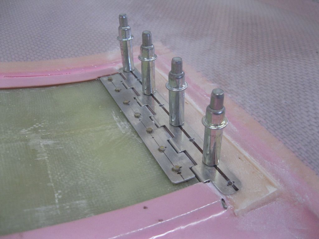

The oil door hinge required a flat surface for attachment to the cowling, so I laid up a nice slab of flox and attached it with both rivets and G-Loc epoxy.

Doug, you might want to run a bit more of the reflective material up the sides of the cowl. Mine is starting to show some discoloration in that area and I'm planning on adding some fiberfrax and reflective shielding up the sides of the lower cowl.

Thanks for the replies and insight, guys. Yes, the cowling seems never-ending sometimes...I must have mixed up 50 small batches of epoxy and micro for various small jobs. I don't think I'm up to doing all the pinhole filling and external finishing, so I've resigned myself to write a bigger check to the painters to have that done.
Bruce, thanks for the tip. I've got some of the aluminum tape left, so I'll add a couple of strips up the sides. My "thermal coating" material is actually Harbor Freight aluminum tape. I tested a piece applied to some scrap fiberglass with a lighter...cooked a spot with direct flame for a good 30 seconds and the adhesive stayed put. We'll see how it performs in the real world.

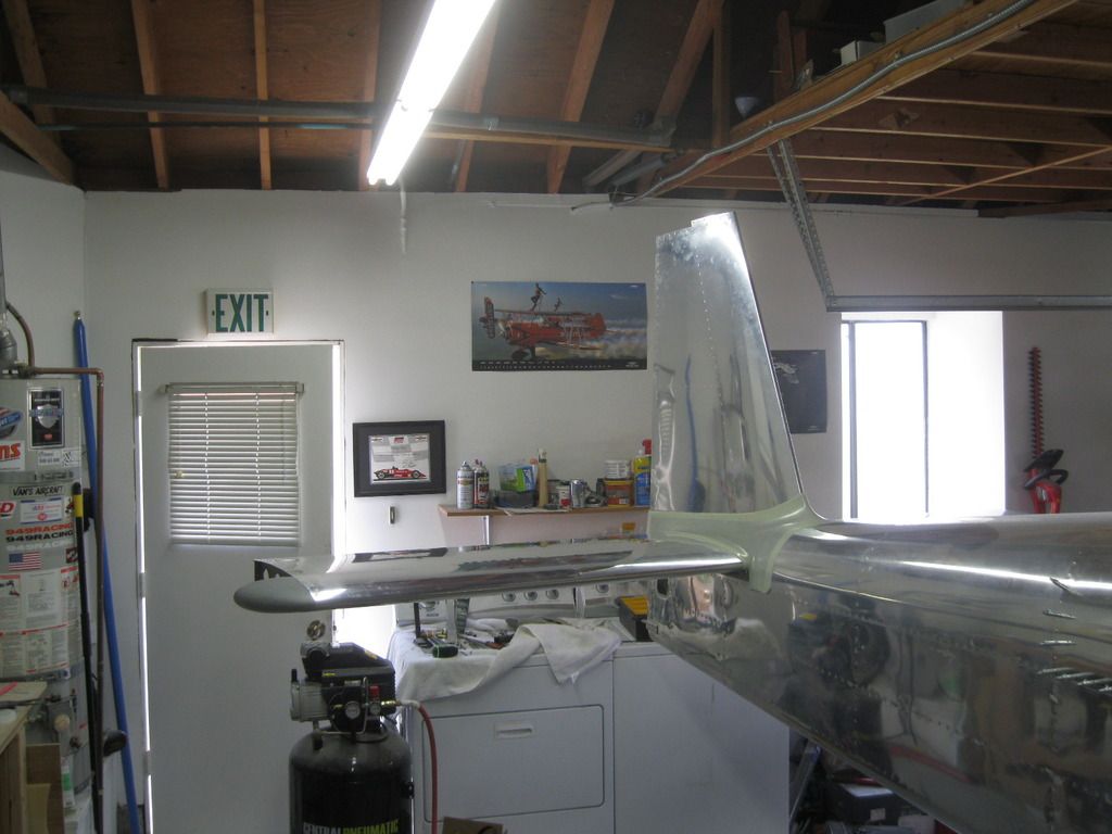

To fend off cowling burnout syndrome, I had to work on something else. So last night I swung the plane 90 degrees in the garage, bolted on the tail feathers and did an initial fit/trim on the empennage fairing. The fit is actually pretty decent, but the parts overlapping the horiz. stab's LE need to be recontoured, and the left side up against the vert. stab has too large a gap. I've worked it over pretty good with a heat gun, and I'm sure there a few more gains to be made this way, but at least a little fiberglass surgery will be involved. Access to the washer/dryer is a bit compromised!!
