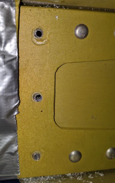

Originally Posted by WVM View Post
Hi,
Hi,

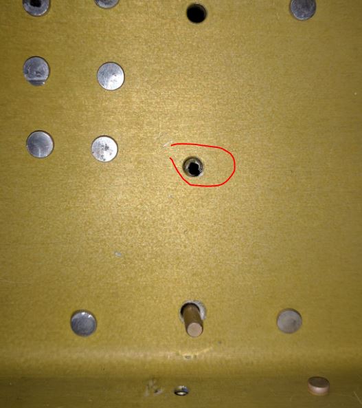

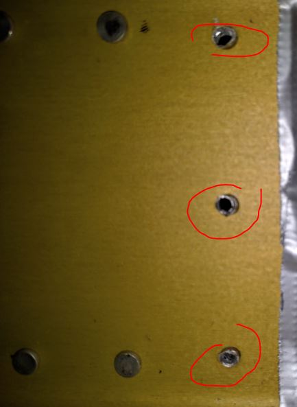

You might remember this post... I drilled those out today after reading this comment on the forum about drilling out rivets or not.
The second reason I did is because I noticed that my new yoke is able to reach all those rivets.
I have an issue after drilling them out. As I used a smaller drill size, I have some remains of the rivet in most of the holes. They don't want to come out as the outside part is larger than the rivet hole (on both sides). The most logical idea was to use a pliers, but this fails. Another idea was to drill them out, but as the remains are not evenly around the hole, they tend to swirl around rather than drilling away and chances are there that the drill will damage the hole as it is not perfectly aligned with it.
Any advise?
RV9 #92188 - Working on wings

Just get a small nail punch and a light hammer to tap the edge of the rivet (inward toward the hole) in a few places. You can then give them a tap to drive them through the hole. Doesn't take much force. Avoid the spar and other parts with the punch.

Drilling too deep with a small bit and leaving the shell is a lesson learned. Like said, take a proper size punch and knock them out. If you end up with some discarded parts, practice rivet removal on them. You will get there, and be able to use a standard bit and make it work.
Rivet removal is mostly technique, not skill. You have to be able to see a human hair down there so good eyesight, cheaters, or optivisor should be used. I drill the head in several steps, a few revolutions per step. If the hole is not in the center, then walk it. Take a bunch of universal head rivets and learn to walk your drill point. This will keep it in the center. Using an angle drill is a whole other skill set!

You could consider grinding a special punch, kinda like a prow on a boat, to collapse the "tube"
I try to avoid "drilling through" I'll use a standard size drill to get close to the junction between the rivet head and barrel. The head can be removed mechanically, either by putting a punch in the hole and wiggling, or shearing off (470s) with a drift or other punch. You can "punch through as stated above, but I sometimes "draw" the barrel out of the hole by drilling the barrel (not through drill) with a smaller drill. After which I use fine punches I made up on my surface grinder. If the barrel is drilled to the thickness of the parts clinched, the thin punch will pull the rivet out easier I think it may actually stretch the barrel and reduce the diameter (slightly?). Less risk of structure damage if you aren't concentric in your drilling.
